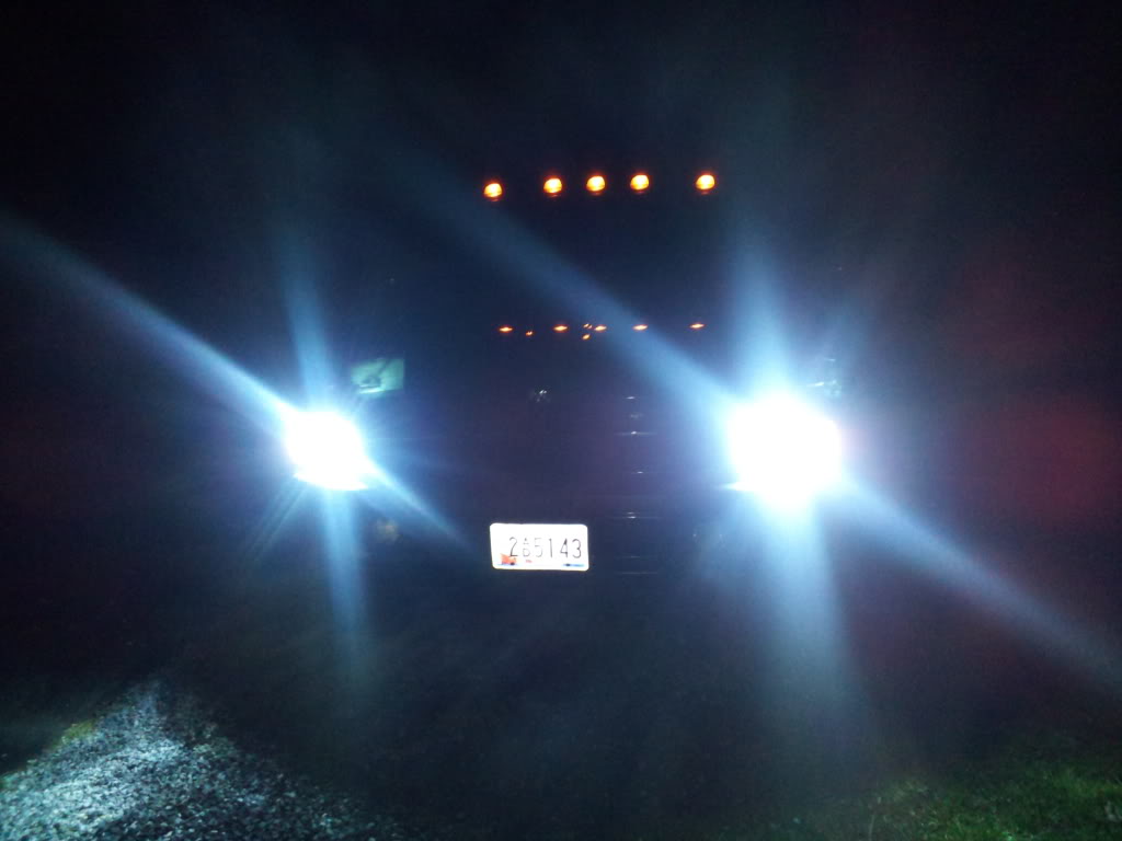

Here is a picture of my HIDS. They are 8000k inside of the stock sport housings. They are very bright and do blind the hell out of everyone around me at night. It can be dangerous for other drivers, but I have not had any trouble yet. Installation is pretty easy, well worth the cost.
