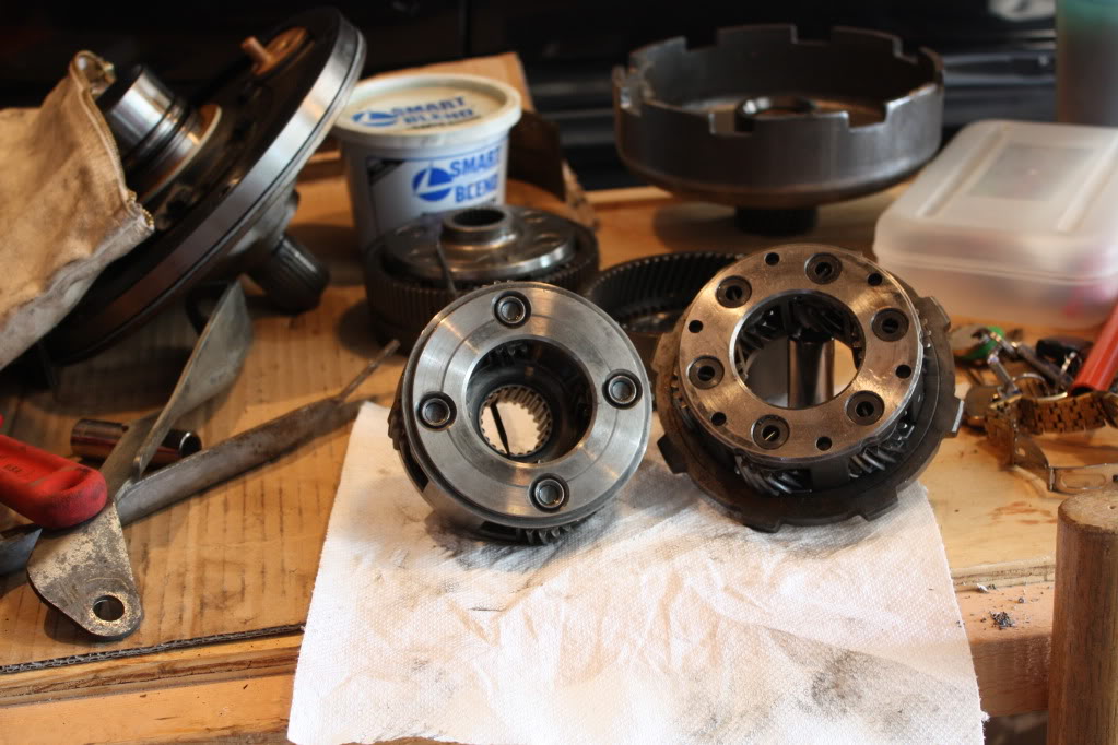

Upgrade on planetary set is from 4 to 6 gears.
High temp frictions, and out additional frictions and steels in direct drum, deep tranny pan, and cooler.
