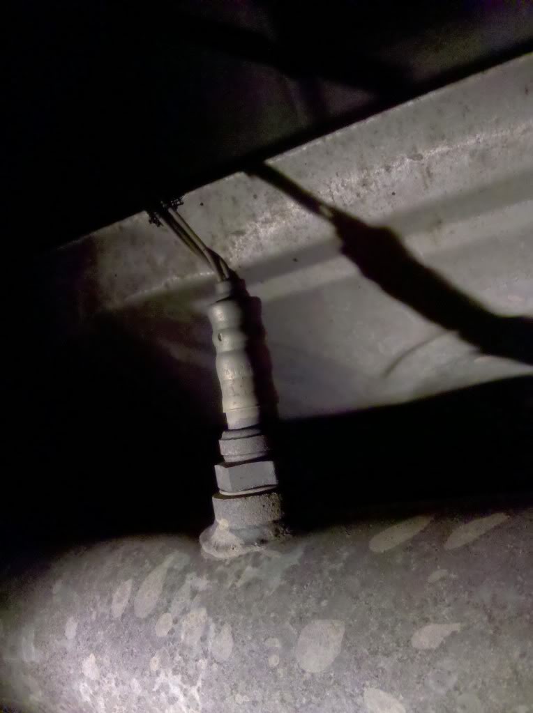

You probably have two O2 sensors, one Pre-cat, and one Post-cat. Post-cat you can probably leave in. Pre-cat is the one that the PCM depends on the most. Its in the exhaust.... hanging out UNDER the truck..... so, convincing them to come of can sometimes be 'fun'...... But yes, it is just that easy. Unplug the connector, unscrew the sensor, screw in the new one, plug it in. All done.

Yes, my pcv is on driver's side. Seems to be the change in our year.
I only have 1 pre, and 1 post O2 sensor. May or may not be same for OP depending on exhaust changes right?
Here is view of my pre and post sensors, respectively:
