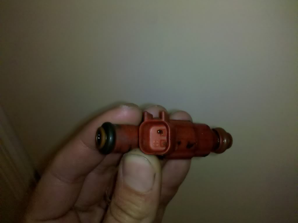

I would try and fix the miss first...... I suspect that you aren't getting fuel there... so, that's not all that much of an issue. There are individual grounds for each injector, sequential fuel injection after all.
Check the wire from the injector, to the PCM first......
the winner is^^

Fosho there ain't no fuel getting in there! With my forward thinking I bought a new injector at lunch time from Napa.
Running now w/ no codes. Took her for a short spin just to squeak around. Nothing broke our sounded inordinate. Of course, its been exactly 3 weeks (tomorrow) that it has not run.

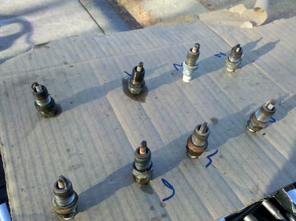

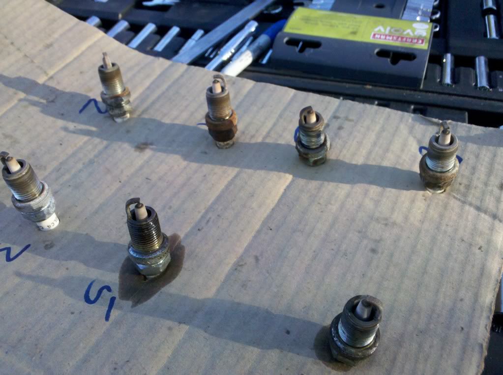

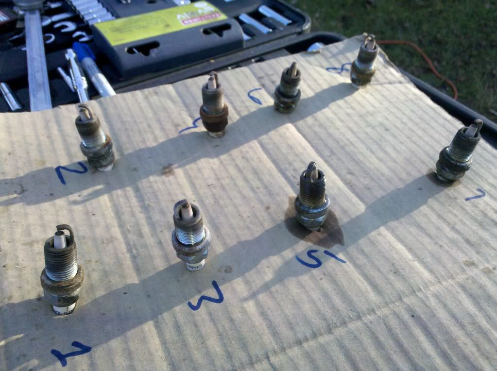

Oh and here are pics of my previous plugs. They all came out dry. Ignore the oil seen on #5. That was a result of overspill of oil on the rockers. They were gaped at something like 0.06.
