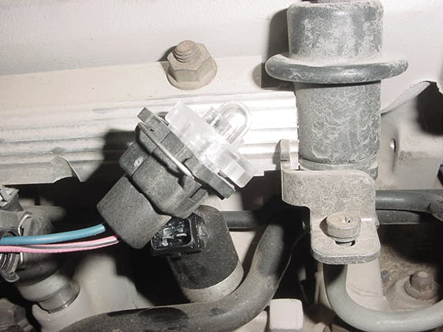

Verify power at that injector. Get a noid lite, and see if you have injector pulse. (provided you have power.) PCM provides ground to the injector circuit, make sure connections at PCM are clean, and tight. Verify continuity of ground wire for the injector as well. Check resistance of the injector.... (especially if you are getting pulse on the noid lite.)
Noid lite will verify injector pulse? Can you direct me to where/how to do that?

Noid lite will verify injector pulse? Can you direct me to where/how to do that? Yep. All it is is a little light, that plugs into the injector connector, in place of the injector. Crank motor, see if light flashes.
