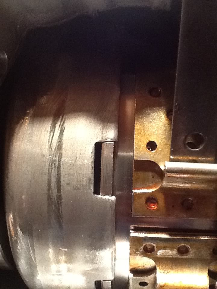

Ok so the transmission got taken appart last night and suprisingly there is almost no wear from the torque converter shredding itself.
I do have a couple questions though. Should i replace this Planetary shell(i think thats the name) because it looks kinda worn where the lugs sit in it...

Is there a tolerance spec for that???

Not sure, I guess that would be a good thing to check. I just wonder because the edges going the one direction are mushroomed a little bit

That might be normal wear.... especially if it's the drive side. If it makes you nervous, replace it. (upgrades are available. )
