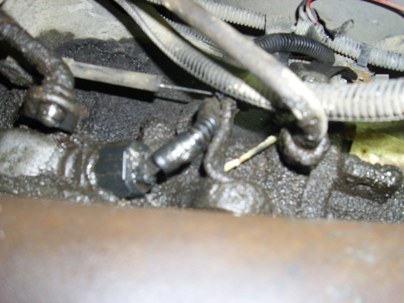

ok looked for the 8 pin plug but only could see a smaller one right above the trans pan. The thing that i was wondering was the 8 pin plug for the other trans for the 98 ? or is it the same for my 46re?

Should be a bit further back on the trans. (maybe four inches or so.....) Goes straight down into the connector. I think you just squeeze it to get it to release.... not sure on that.

I cant see any other connector near that connector i am trying to pull off. It is on the driver side. Here is a picture of it:

Old Jan 28, 2012 | 08:06 PM
Posts: 87,399
Likes: 4,214
What year is your truck?
