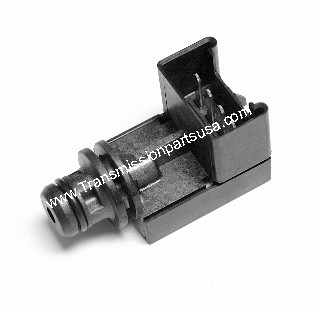

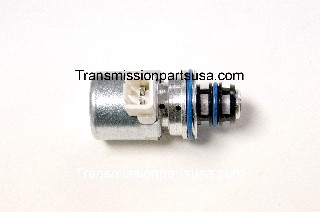

Thanks HeyYou! Mine was so packed with crud it looked like part of the transmission. Got it off and took it for a ride shifting was good didnt go over 40mph but it was right around 2k rpm @ 40mph. The check engine light came on when unplugged as expected but everything seems good so are these the parts that i should get:
$92 shipped. What do you think?

One is first design, the other is second design. Borg Warner? makes a heavy duty unit, that comes really recommended, as it is much less prone to clogging, like yours are doing.

No the first is the sensor/ transducer and the second pic is the solenoid. Any links to the one you are referring to?
