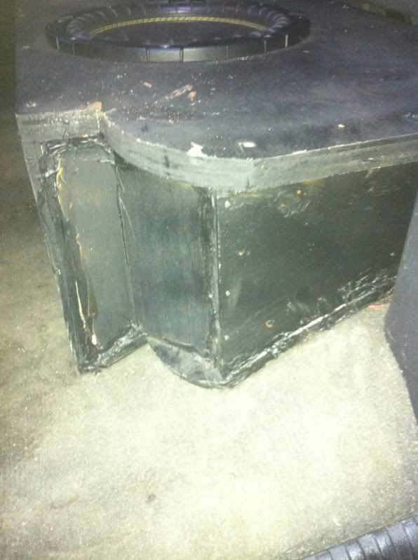

I built mine from scratch using cardboard and really there's no other way. It took me four hours or so but I used every inch down there. I curved the bottom boards and put cut out for the handles. I'll post pictures around 3 today. I would go go 12" subs if I did it again.

you just used the cardboard as a template right?... I looked into this but after measuring I discovered any box made to fit in that space would perform very poorly unless it was for a solobaric sub or an 8" sub maybe. (larger subs require larger volume boxes or they sound terrible).. The volume is just too small and it would be very shallow... I settled on a single 10" box that lines up with my center console and is wedged to sits perfectly between the backseat and against the back of the console.

I made it out of plywood and lots of silicone sealant. It took forever but I am glad I did it and it takes up no useable space (to me). I would much rather have it under my backseat than in my middle seat. Well heres the pictures and sorry for the delay
