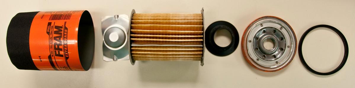

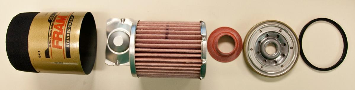

You know, FRAM does make one line of decent filters ... the XtendedGuard. The tear-aparts I've seen show a well made filter, with all the stuff you want: silicon anti-drainback valve instead of nitrile, mesh backed media, synthetic media, crimp-on steel end cap, maybe a little light on media but that's about all you could complain about.
People who have run particle tests on them say they filter very well.
They cost about $8 which isn't bad considering the performance, which reportedly is in the same ballpark as the Mobil1, The Royal Purple, the Amsol, the K&N, etc. which can be almost twice the cost.
The problem, of course, is recommending one to somebody. FRAM makes at least 6 distinct lines of Oil Filters, and some of them are not only cheaply made but don't filter well either. The boxes all look more-or-less the same.
I'd hate to send someone to an auto parts store for one and have them come back with, say, a PH-series ("ExtraGuard") (nitrile, cardboard end cap, yadda yadda yadda).
I also wonder why anyone who looks for FRAM at the store would then pay $8 for a filter. People buy FRAM because they are usually the cheapest filter on the shelf and they feel for something they're going to throw away that an extra dime is money flying out the window. I don't understand how Honeywell managed to conclude that you can use "FRAM" and "Premium" in the same sentence.
Anyway, for what it's worth, if you pay attention to what you're buying you might be able to save a bit over some of the other premium filters.
I found some photos. PH series and XG series. The way they stuff the media in the PH you'd think paper was the most expensive part.

I'm not impressed at all with Honeywell....look what they did to Autolite... bought them and basically closed them down and now have all the products made by different companies in different 3rd world countries "under license" to use the old autolite name and designs... you could buy 8 of the same part# sparkplugs for a tuneup and have some those eight be slightly different than each other, being made in three different countries depending on batch number and who was cheaper to use at that time....(I'm speaking from experience on this one)
