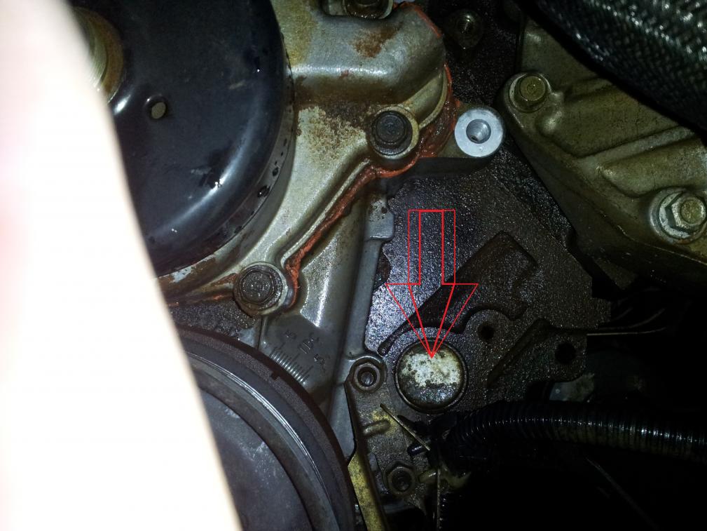

Alright guys, just wanted to give an update and ask another question.
Today the weather was nice so I was able to get back to work as I await my delivery from auto zone. I flushed the cooling system and radiator today then decided to give the engine a nice bath as everything was disgusing.
As I was cleaning, the fresh anti freeze that I added to the engine started pouring out of what looks like a freeze plug to the right of the water pump. I noticed that there is another one of these plugs to the left of the water pump.
So I just was wondering if there are freeze plugs, both of them? Obviously I will be replacing the leaking one, do you think I should also replace the one on the left side that is not leaking and are there any more in there while I have everything ripped off the front of the motor?
Thanks Guys, I hope everything works well when put back together.

Freeze plugs are in the block. Can you post up a photo?

I probably can, just don't know how. I will try to figure it out. These are on the block opposite the radiator a little bit lower then the water pump on the left and the right.

Okay, First attempt at uploading....
Attached Thumbnails Coolant Leak...New Location-20120215_173303.jpg   Coolant Leak...New Location-20120215_173242.jpg

Looks like a freeze plug to me. If it's leaking then it's time for a new one, probably best to do the other side too.
I've not had to install one so I don't know the exact procedure, but I thinking you might need to drain the coolant, knock out the old ones, and punch in the new ones.
Someone will clarify though!

That's a freeze plug. Betting all of them are corroded from the inside out.
