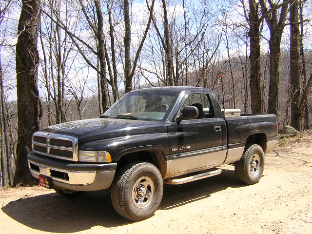

this is 285/75/16 all terrains. stock suspension. no rub, no problems.
but - i wouldn't go any larger with 3.55 gears.
