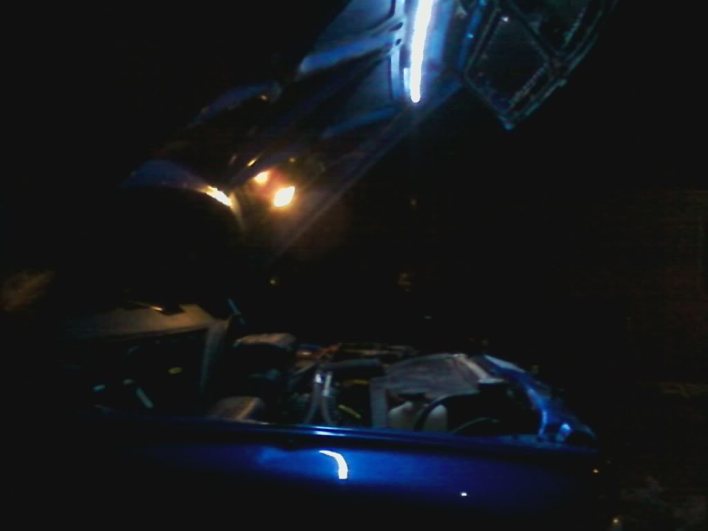

Yep works

I have LEDs behind my grille and I stole power from the under light and have it wired to a switch, and i haven't had a problem.
They have been in there for over a year
