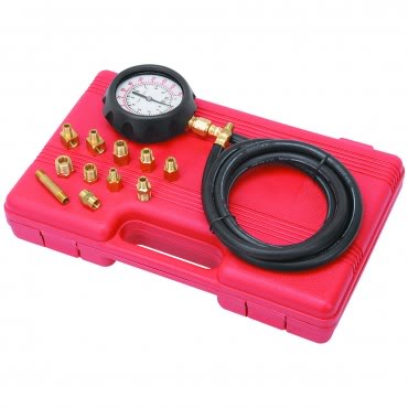

You need to actually test the fuel pressure. 20psi will squirt out pretty far, but will not make truck run correcctly. Get one of these or borrow from parts store -
You need 45 to 50 psi.
