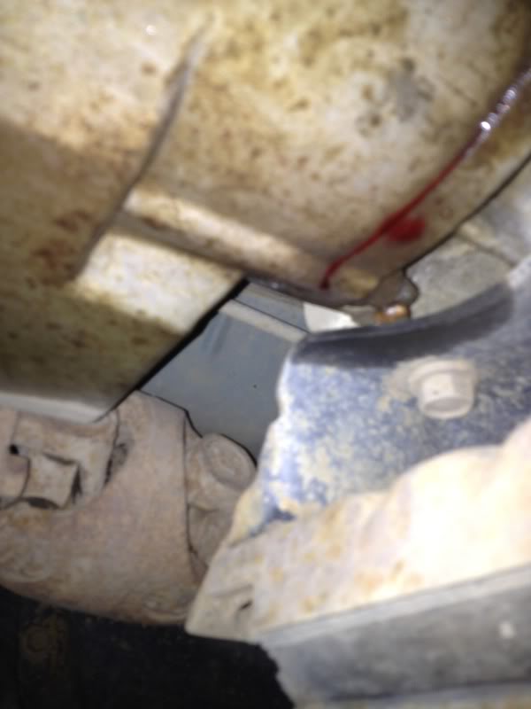

I took a better look. It appears to be leaking from the front where is bolts to the trans and it's dripping down to the center of the tcase becuase that's the lowest point.
Does the whole tcase have to be taken apart to replace that seal?

Old Mar 29, 2012 | 11:06 AM
Posts: 87,572
Likes: 4,233
I think you can change the front seal, with just dropping the t-case.
Old Mar 29, 2012 | 04:38 PM
zman17's Avatar
zman17
Retired Moderator - RIP
Posts: 18,729
Likes: 17
From: NH
Yes, the output tranny seal and input transfer case seal need replace.
Old Mar 29, 2012 | 05:52 PM
Wombat Ranger's Avatar
Wombat Ranger
Joined: Sep 2011
Posts: 5,672
From: Wild West
This is the front of the tcase. Unbolt the 4 bolts to the input bearing retainer and it comes right out. then you can put in the new seal and bolt it back on. Simple stuff.
Old Mar 30, 2012 | 03:00 PM
corner27's Avatar
corner27
Joined: Apr 2011
Posts: 21
Well I got it all apart this morning. It looks like it's the tranny seal that has becom brittle and cracked in several places. I will replace it and the transfer case seal while it's apart.
