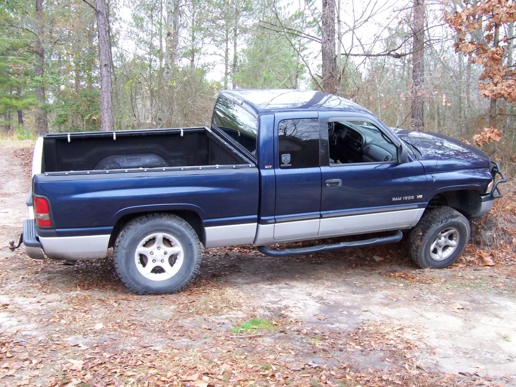

The bed looks like it sags more cause the front is raised. Just throw those 2" aal's under there and be done. It'll also help with payload, somebody on here said it actually lowered the payload on there's but I have no idea how adding an extra leaf dropped the amount of weight they could put in the bed? It's a little bigger than yours but for a front to back rake difference, here's mine. It's 7" in front and 6" in the back. So the front is still 1" higher. You'd only be .5" but your rear springs have dropped some over time so it should have a similar rake.

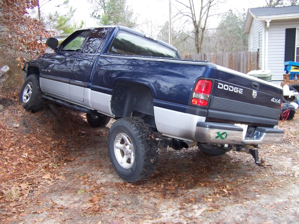

Since you contemplating this for offroading in Moab, then you really want to RETAIN articulation in that back end. The springs have already become worked such that they will articulate much much better. Getting new springs or AAL will just stiffen that up and effectively mess your articulation up. Don't do it.
Get a reverse shackle flip kit. BDS, ruff stuff, etc. You can adjust it for height.

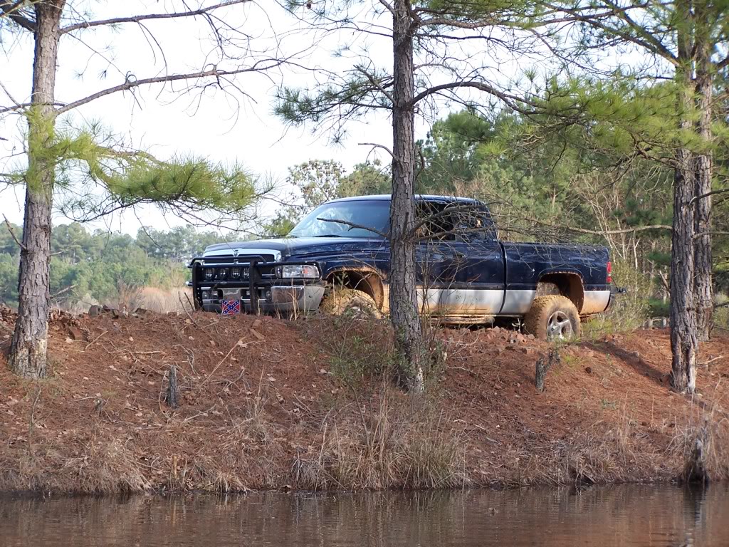

I was going to put a couple pictures of mine (2.5" coil spacer in the front, 2" AAL, 33" tires) but then I saw the articulation comment and remembered a little video I got a while back that shows the height as well as articulation. I extended the front shocks with threaded rod and a coupling nut, I haven't relocated the rear shock mounts yet but I will some day. The add a leaf did stiffen up the rear end a good bit but I don't believe it hurt articulation. The add a leaf does reduce sagging with a load in the bed significantly. Some day I'm going to get actual lift springs but they are expensive. Then again, I might go with those lift shackles, hmm...
I would go with the 3" kit if I were you, 33" tires will look good with it and it should be a smoother ride. Does that kit come with new front springs and a big block for the rear?

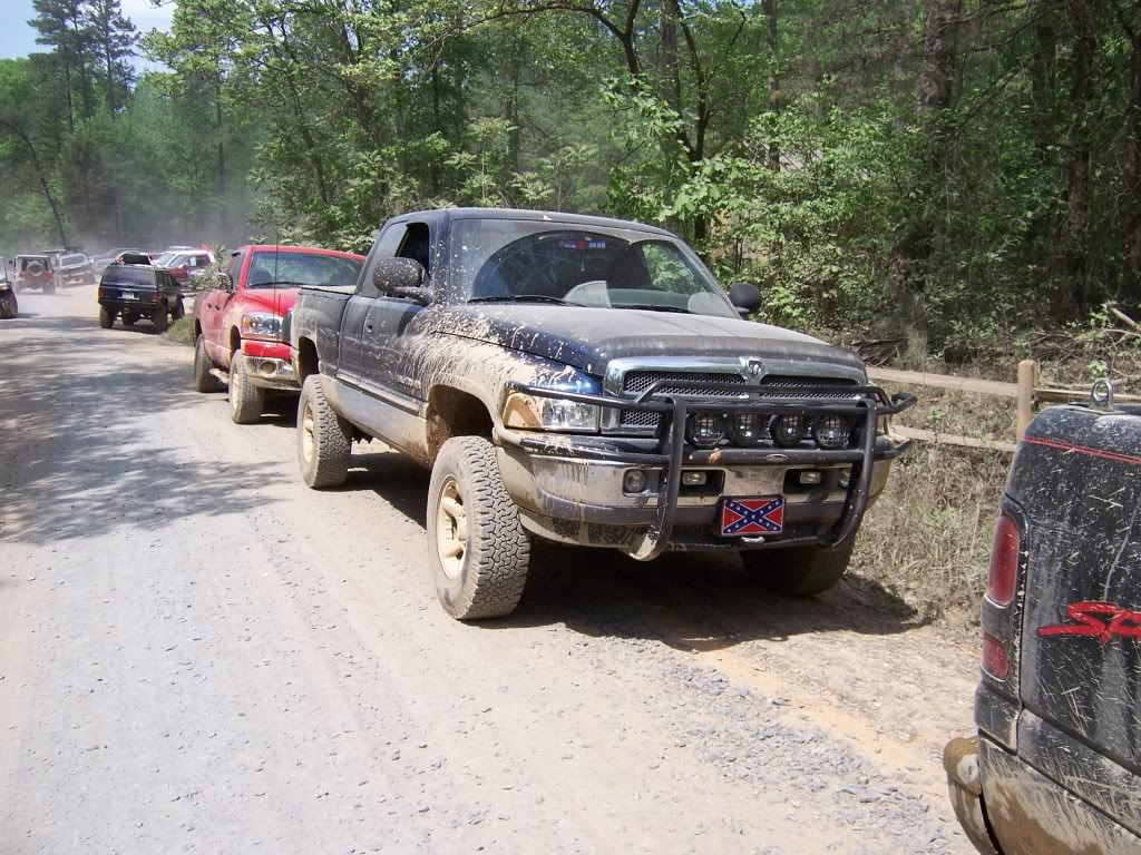

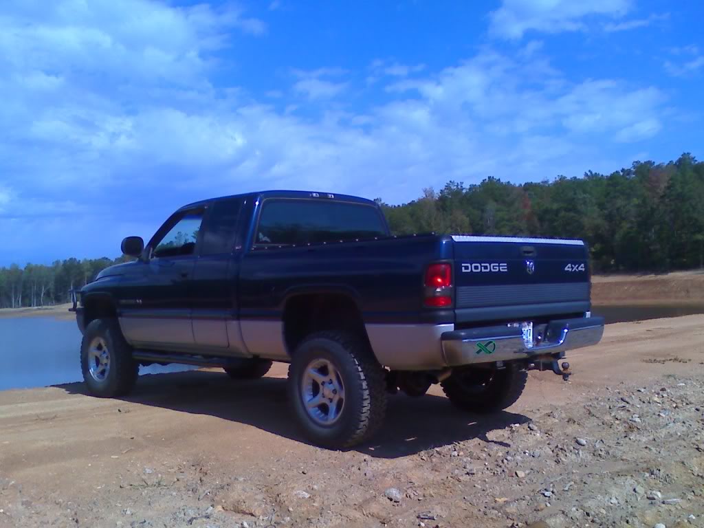

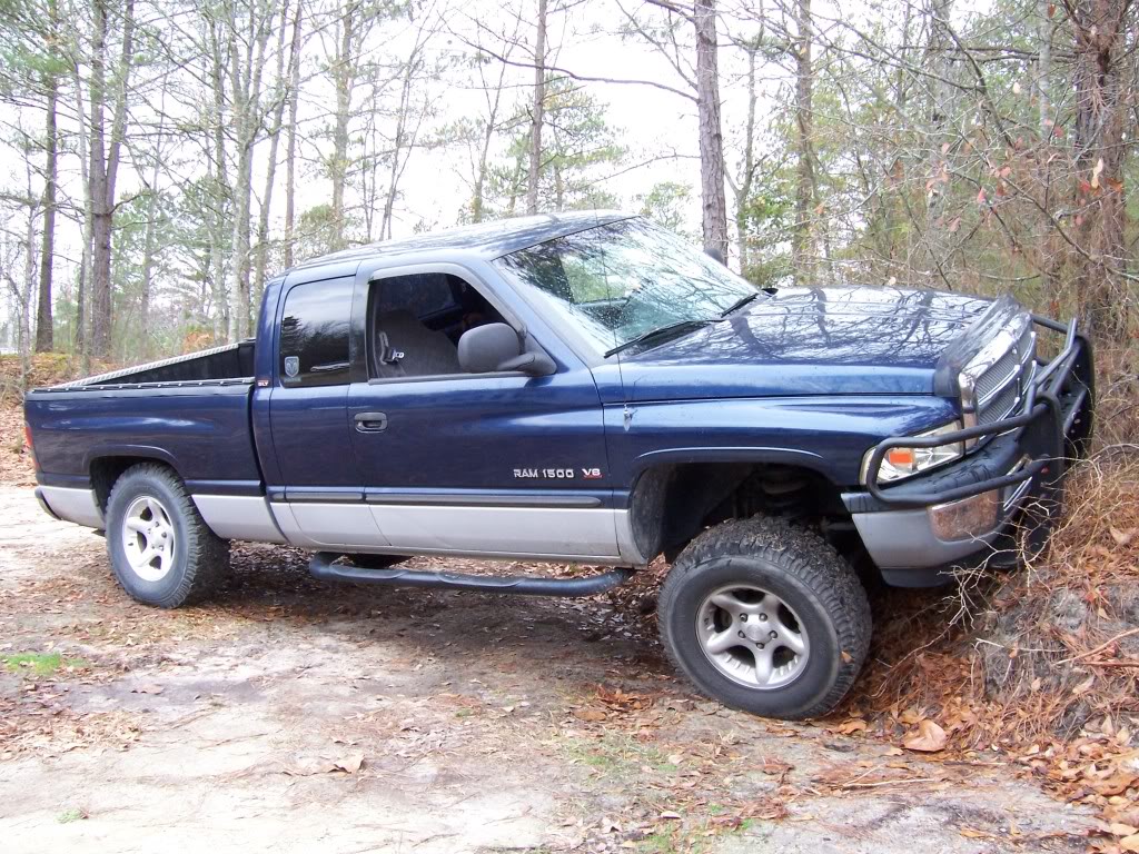

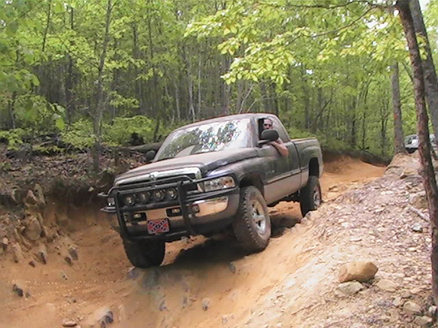

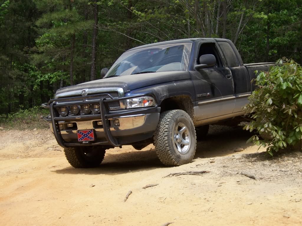

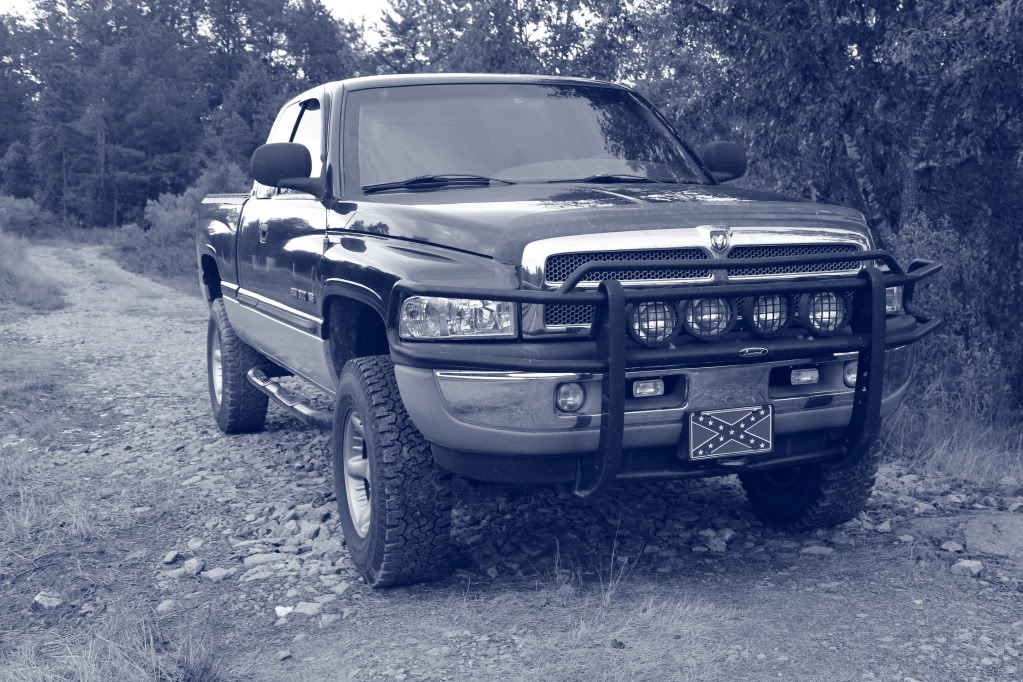

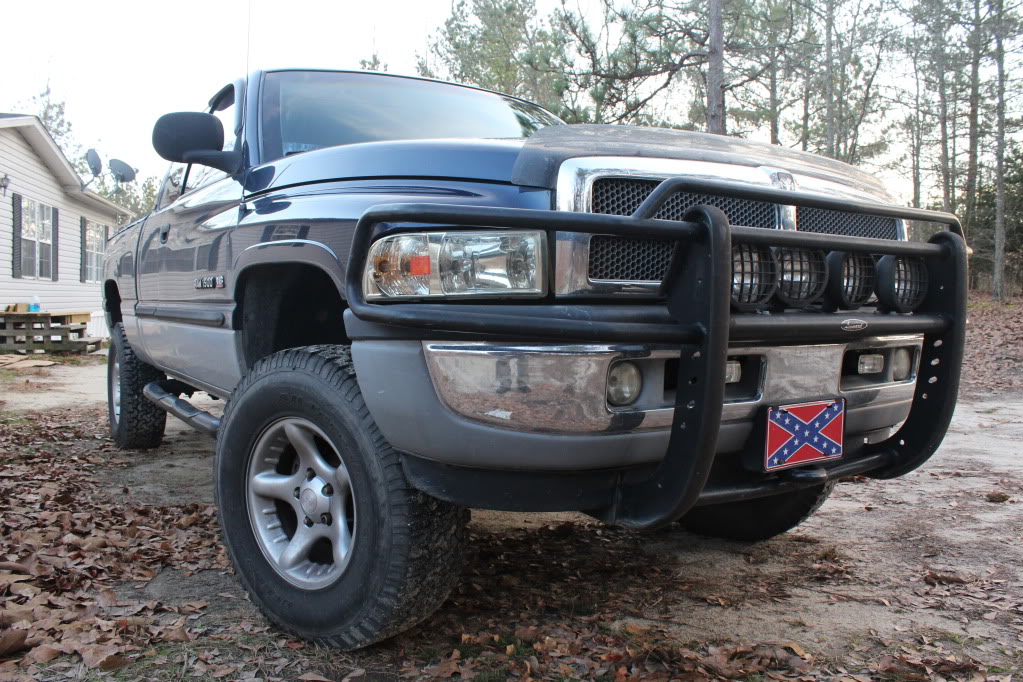

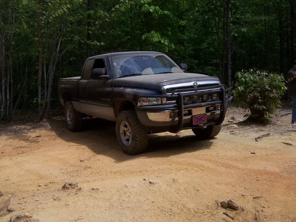

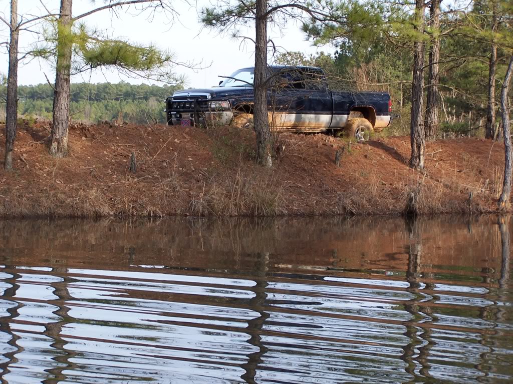

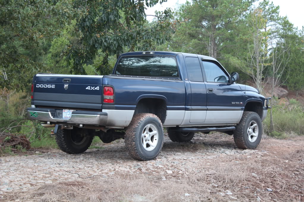

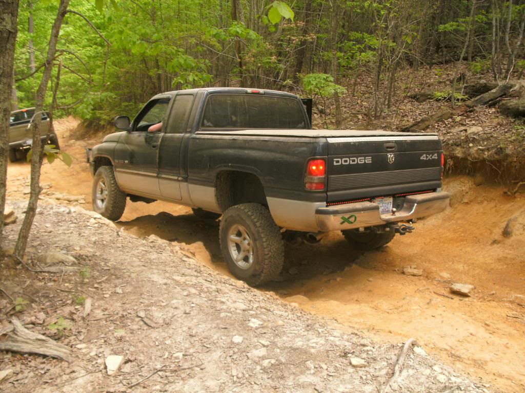

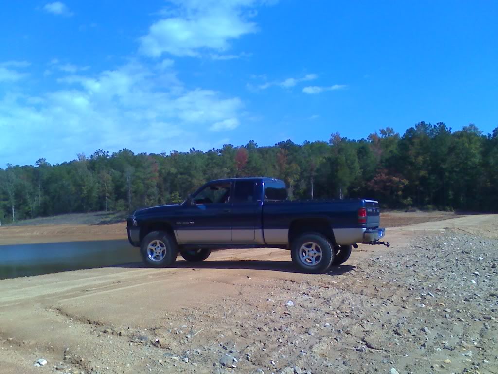

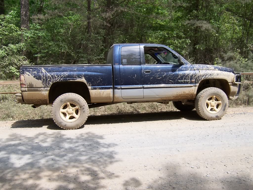

I have plenty, I'm sort of fond of my truck. Here are some pictures.
