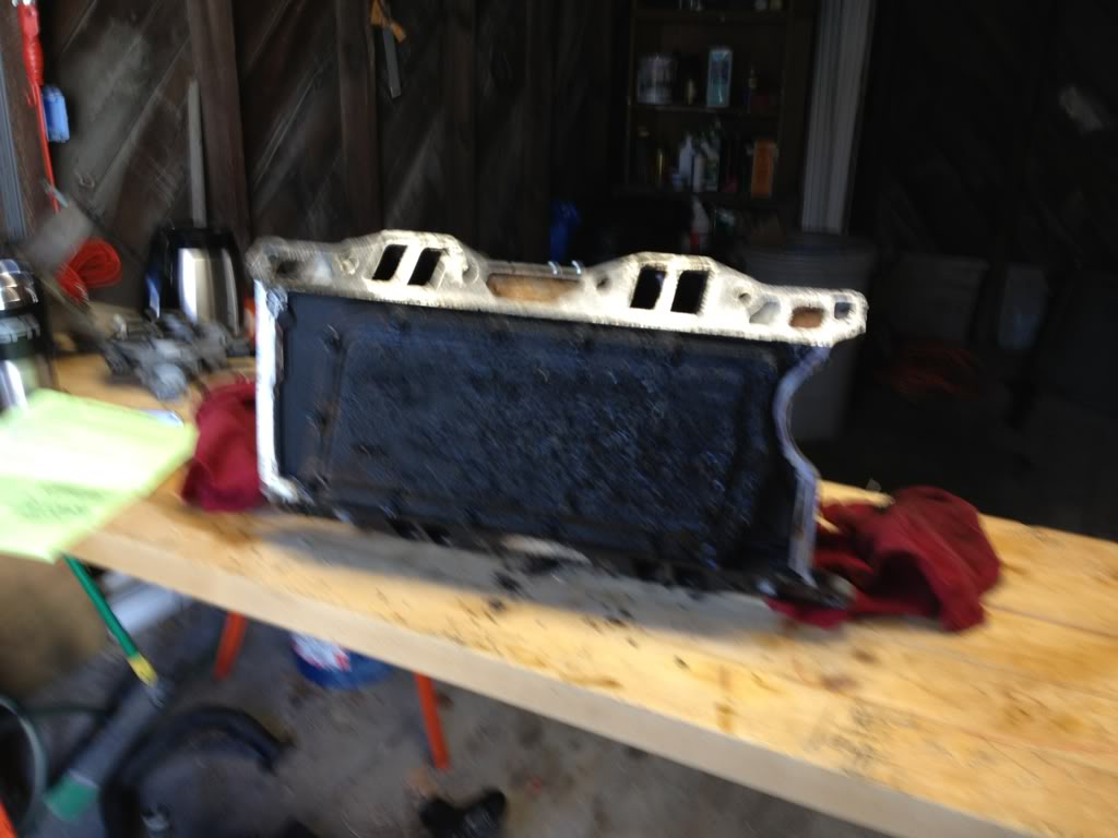

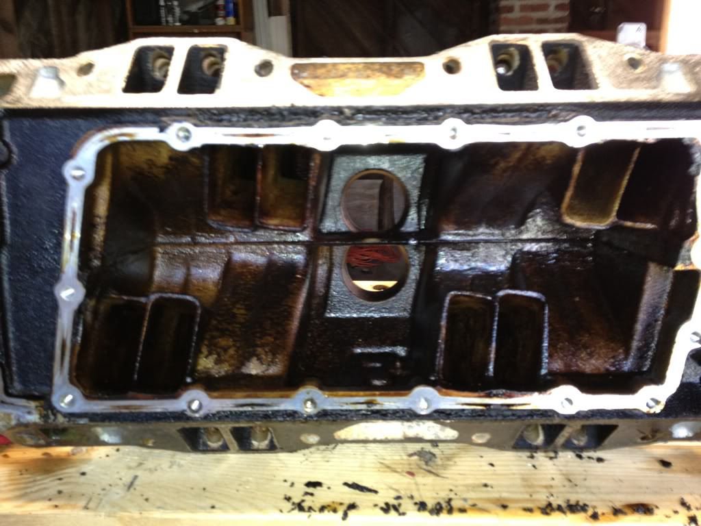

Ive got the intake and belly off, about to clean the intake and cut the runners. I'm also gonna mod the throttle body while it out.
So far I've only broken the coolant temp sensor, everything else has gimme according to plan.
When I pulled the fuel rails two injectors popped off the rail, I got them out of the intake. They look like they just pop back into the rail. Please tell me this is the case. New injectors are expensive.

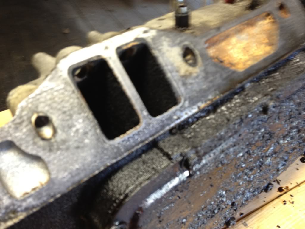

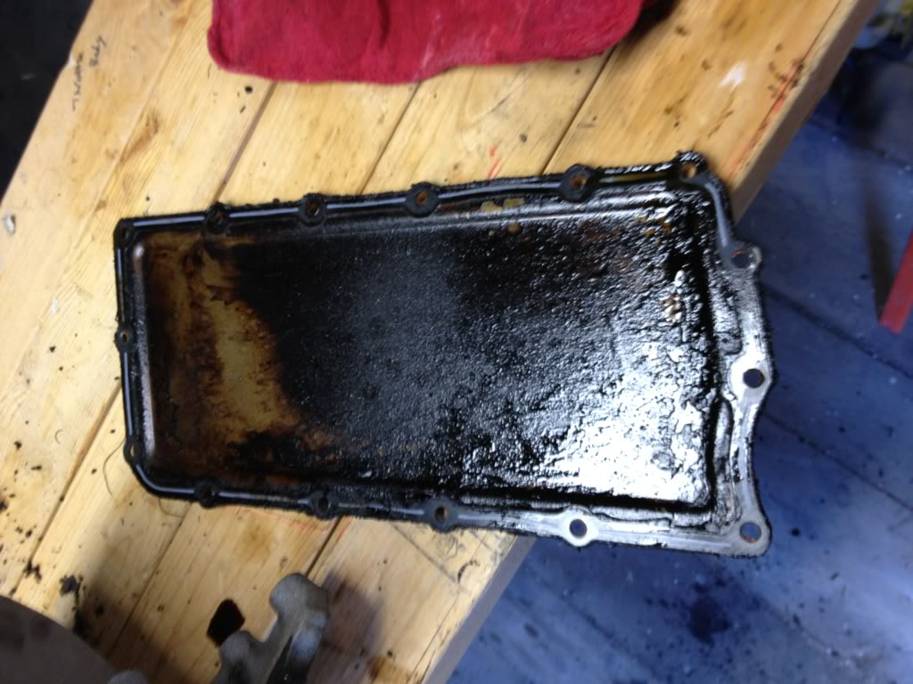

The gasket for the plenum plate was competlely gone, only a few little spots remained of old clumped gasket.
Here's some pics

Yours looks preeeeetty greasy i must say lol How long have you been running it like that? God knows how sludgy mine will be when i get around to it haha.

200,000 miles on the ole 360. It's pretty bad. Who knows when the gasket went.
Doing timing chain also
