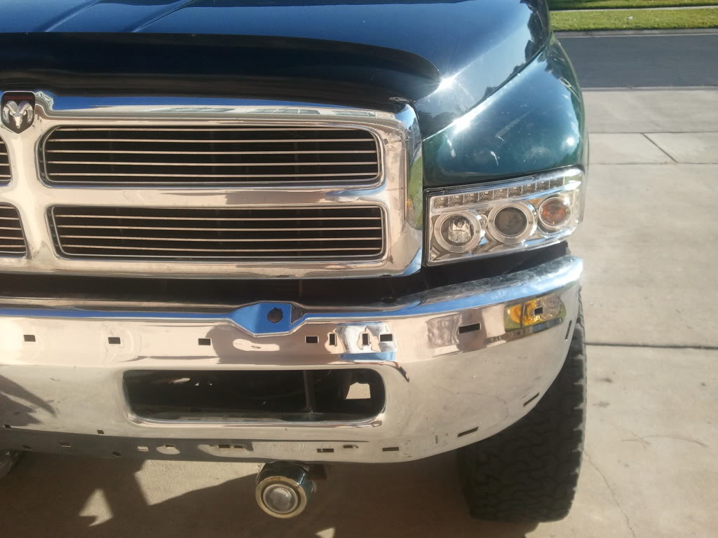

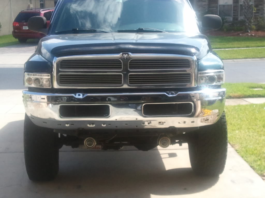

alright i've figured out the photo thing, here are some pics:

Yes the bumper is missing something.... I like it all chrome like that, if it weren't for 650 holes I'd leave it
