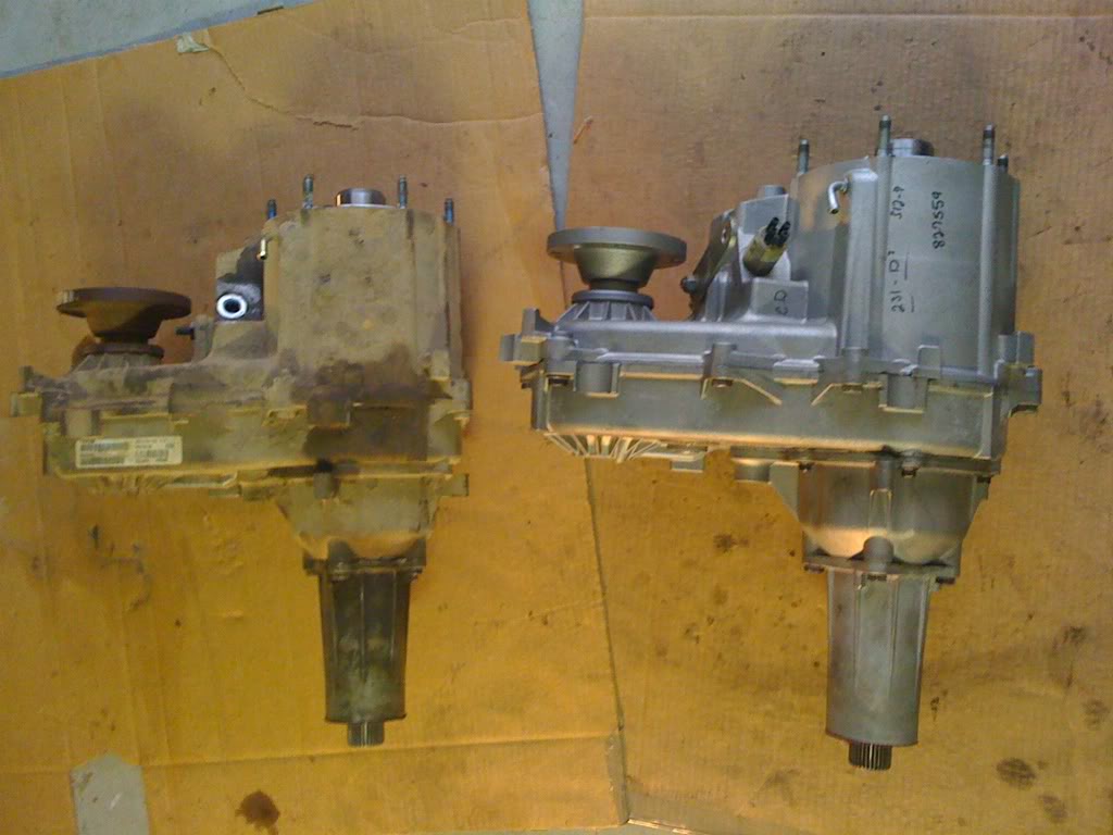

i'd call it the drive shaft yoke/flange. it's splined, slides onto the pinion shaft, and attached by a big nut.
its the rear end equivalent to the front yoke on this t-case.
this is the closest pic i can find

but it its like whats on the front it just bolts to it.. is it like a 2 piece set that you can buy? one half slides on the pinion and the nut is on it then the other part that acutally holds the u joint bolts up with 4 bolts. does anyone know if they have different sizes?

i wonder if the front on the transfer case "cvflange hub thingy" is the same as the rear if soo... i might have an idea.. maybe just maybe.. lol

oh and its because i have a 241dld now not a 231 transfer case. and yoke is bigger u joint.
