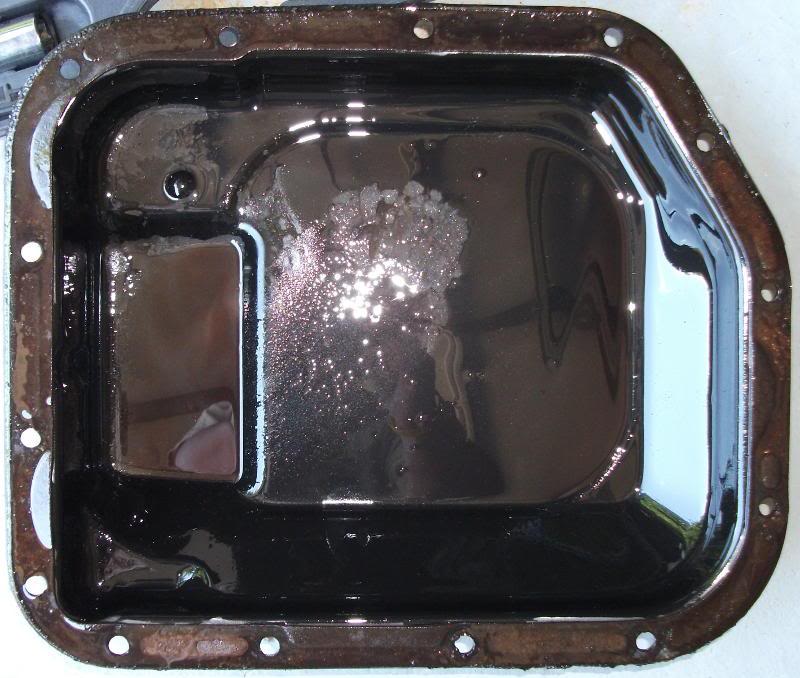

2: I dropped the pan. The filter was dirty so I put a clean one on. Inside the pan was the following:
The central mass was a thick oily sludge with what I would call a fair amount of fine metal filings. Also, there was sludge and filings collected in the upper left-hand corners of the pan (both the lower indent, and the higher corner). I cleaned the pan and re-installed it with a new gasket. While I was under there, I adjusted the Kick-down Bands per the specs in the Haynes manual. (72lb, then back off 3 front, 2 rear.) I refilled with ATF4 and ran the vehicle through its gearbox, plus a test drive. No change.

Also, the sludge at the bottom and on the magnet are pretty normal. That's why there is a magnet there.

Thanks for all the info. I will have a look for the documents you mentioned. As I have never changed the oil in a tranny pan before, I had no baseline, so I didn't know if I was looking at a normal, or abnormal, amount of sludge and filings. Thank you very much.
