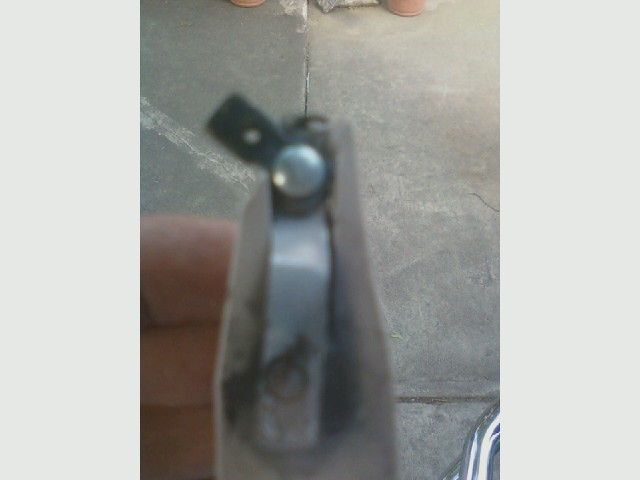

That could be a problem. That's the new rotor i put in last night

That would make it run like crap. but not the smoke issue.
When you put the rotor on, when positioned correctly it will snap into place. Otherwise, it sticks up to far....and THAT happens. It can be a little tricky, expecially since Dodge put the thing way at the back nearly out of reach.

I put the old one back on and it runs fine now. Yeah it was a pain to get back there.
