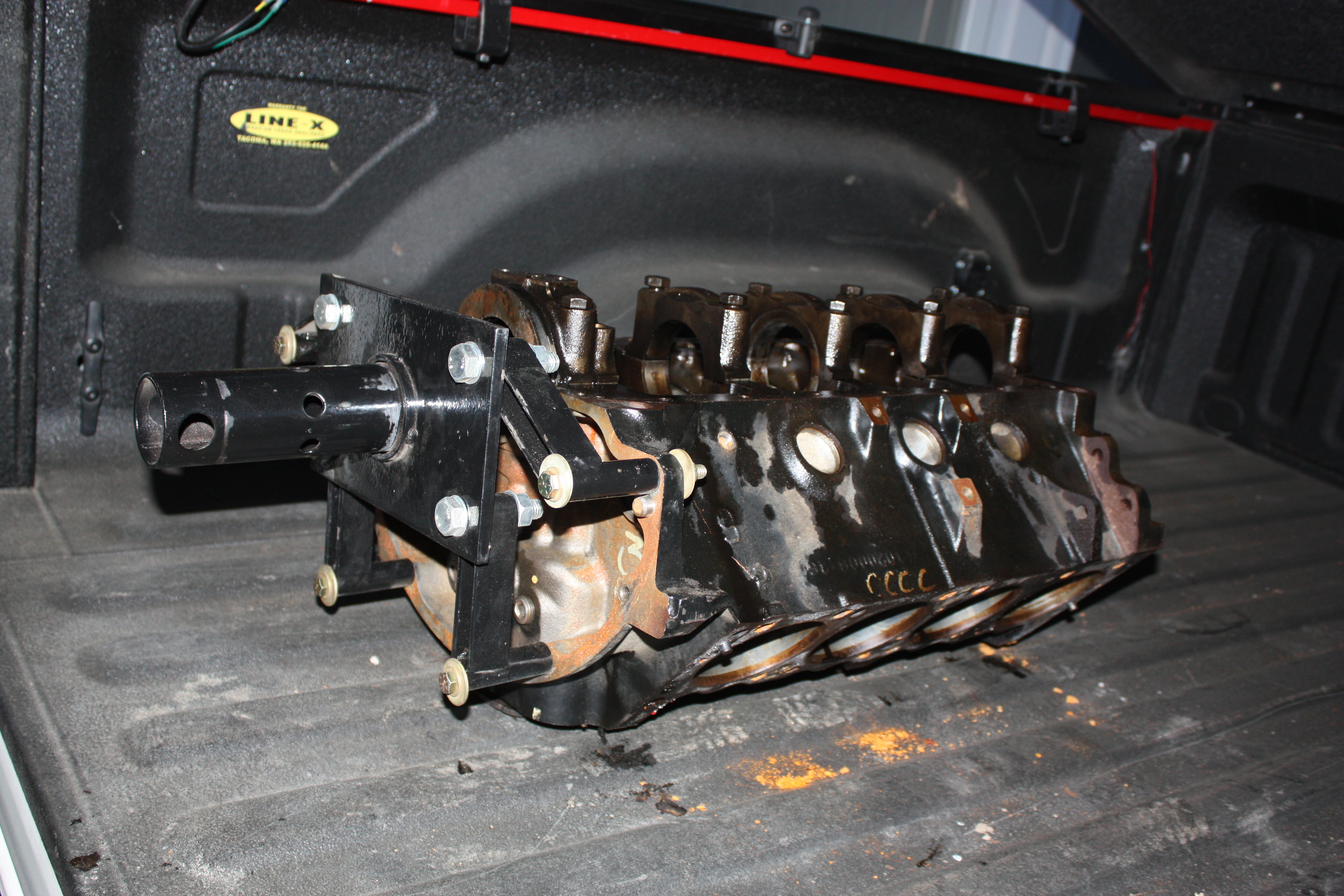

Well nothing exciting to report at this point. Had a buddy come over today and he helped me load the engine into the bed of my truck. I will take the engine over to the machine shop on Monday. Then we will see what the machine shop has to say. Fingers crossed that the block will be good and this will stay a cheap for now build.

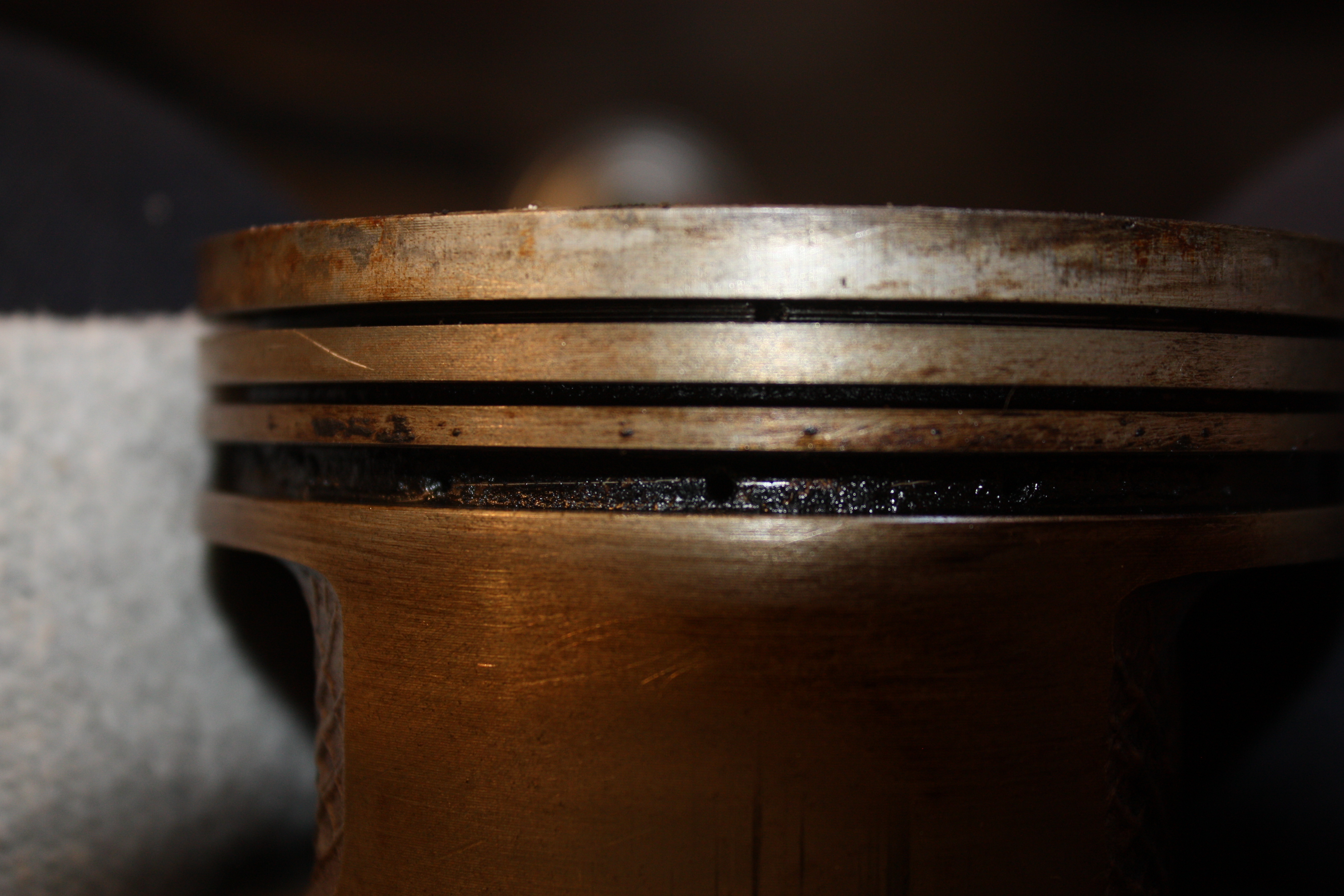

I want a stroker too....................Anyone want to donate to a disabled vets engine build project? I will build a stroker sometime in the next two years (I Hope) once I get moved and then the wife gets a new job. This fixed income thing sucks.
The more I work on this engine the more I really think what happened to this engine was that it was using oil and not running right because of the amount of carbon built up. Now I am not an expert engine builder and I have only rebuilt a few engines. But this engine has had tons more carbon built up than any I have seen before. I have seen engines that had worn cylinders and a ridge built up at the top of the cyl that didn't look as bad as this engine.
I have been cleaning pistons the past two days and finished them off today.
Here is one of the last pistons before I cleaned it. I wish there was a way to show you guys just how much carbon there is coming off these pistons. And take my word for it that this piston is one of the cleaner ones.
Some of the pistons had so much carbon and crud built up that the rings were stuck in the pistons.
