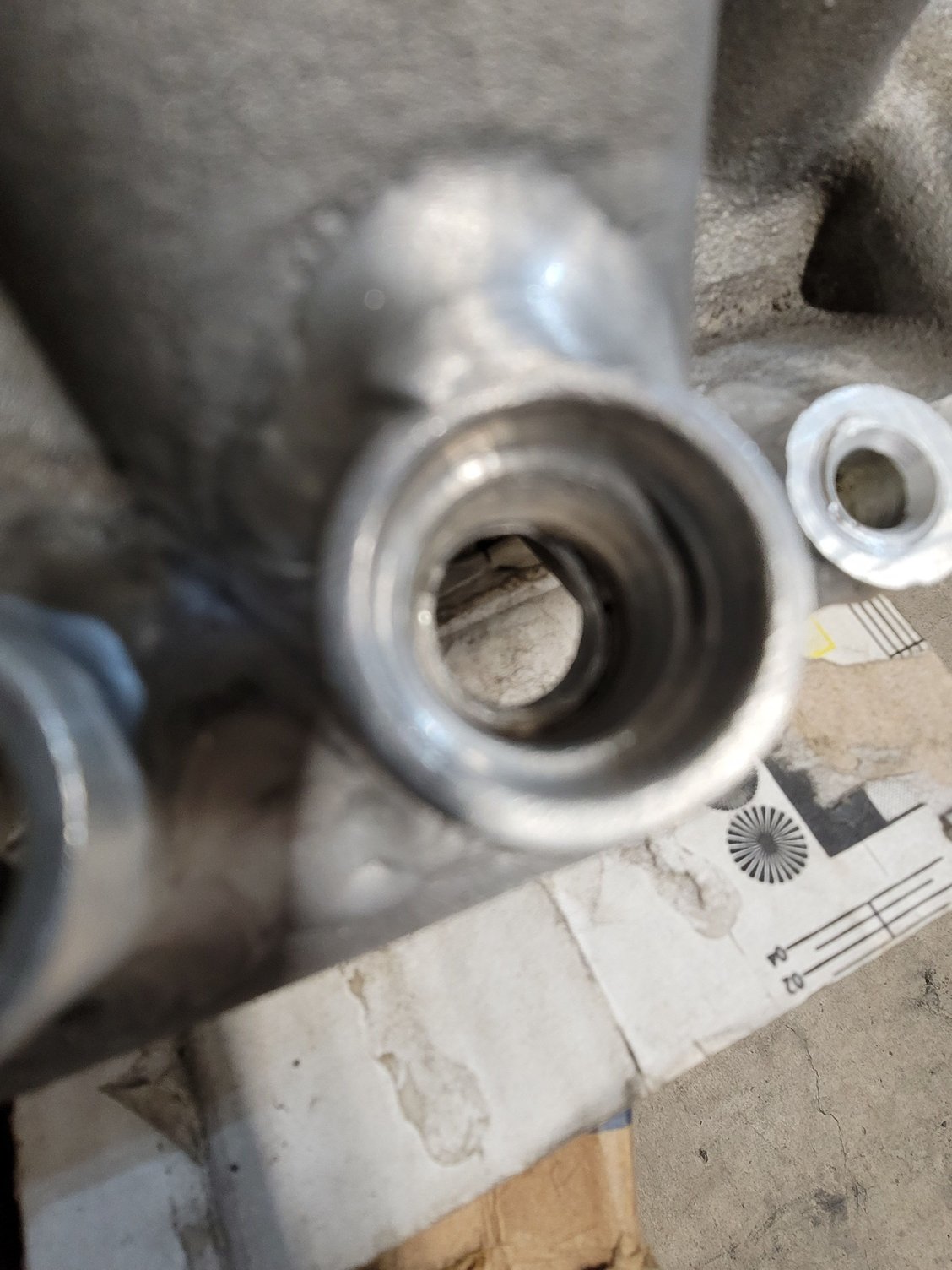

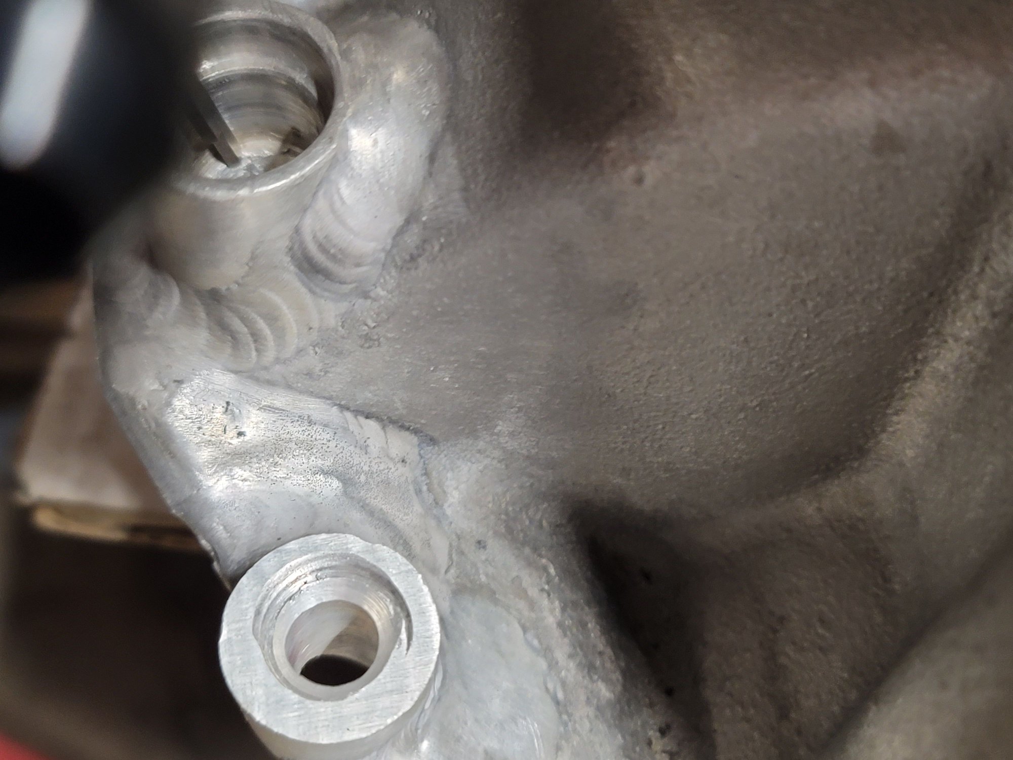

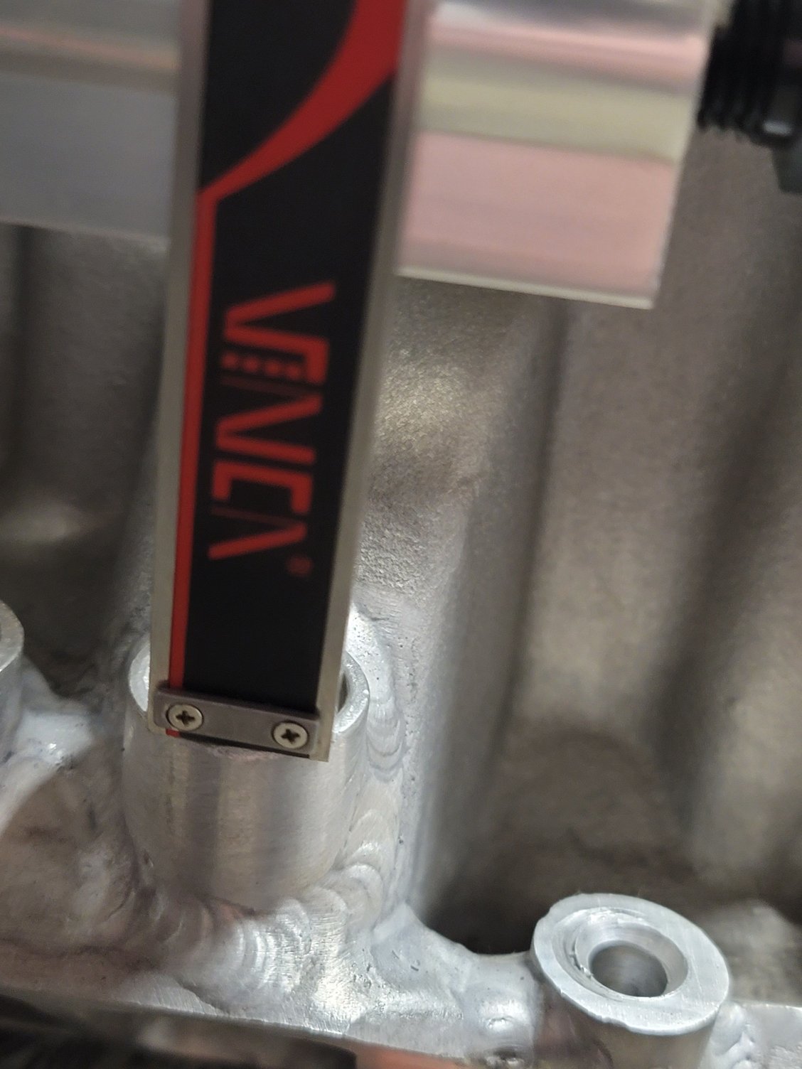

You could probably torque 'em to 100 ft/lbs and still not be in danger of breaking the manifold.
You probably are correct but with my luck the way things have been going on this whole project I'll break it.
Because the intake was originally for a LA engine I think the bolt holes are welded onto the manifold but not really sure. The injector bungs are welded in.
Not the best pictures but this is what I had.
You can see where this one was welded onto the manifold.
