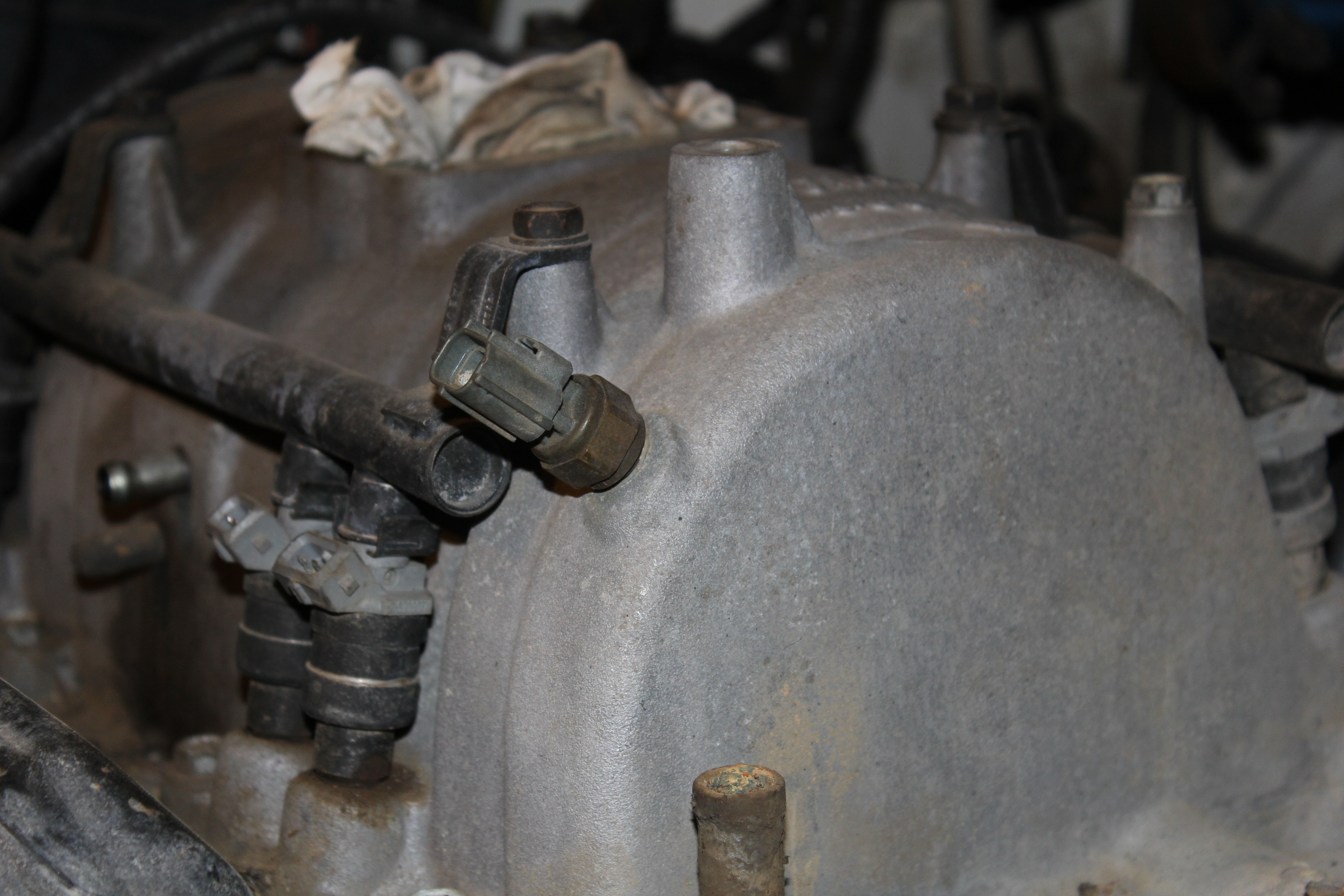

Well I have spent the past 4 days with my internet going in and out with OUT being more than in. We live out in the country so have Hughes Net satellite service. The installer hadn't installed the dish correctly and we had some real high winds the past few days that had knocked the dish out of alignment. So the repair guy that came out moved it and set the 3 legs of the mount correctly. Now I have internet again so can post up some stuff.

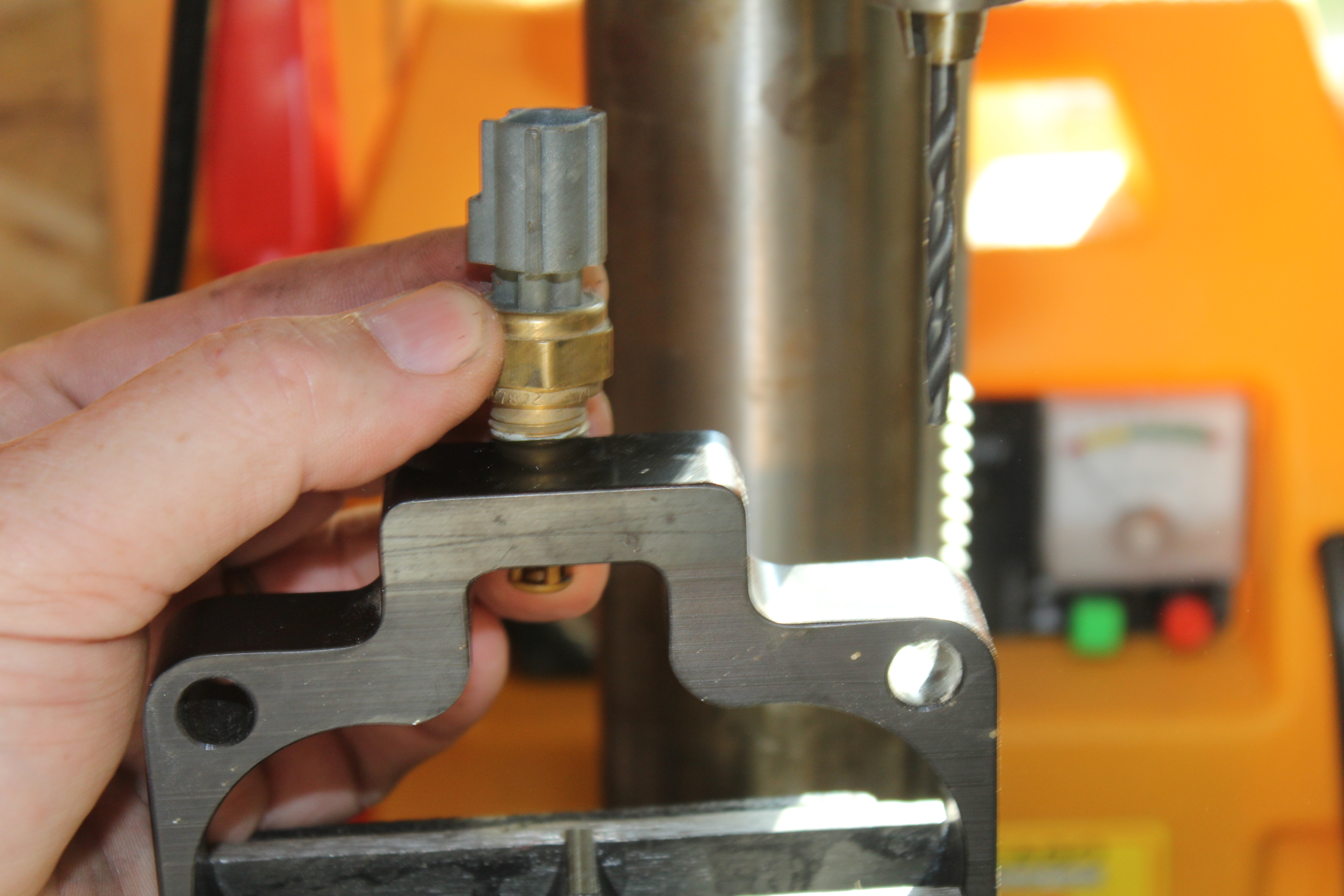

I haven't gotten a lot done to the Jeep this week other than removing the front and rear drive shafts. Today I decided to work on making my mount for the IAT since there isn't one on the Air Gap. Now I had a throttle body spacer that had come with some other parts I had gotten off Ebay a long time ago. My plan was to drill and tap a hole in the spacer to install the IAT into it.
So after looking at all my options I decided I'd install it in the rear of the spacer directly below the IAC. The IAT is a 3/8 NPT so you drill a 7/16 hole and then tap it for threads.

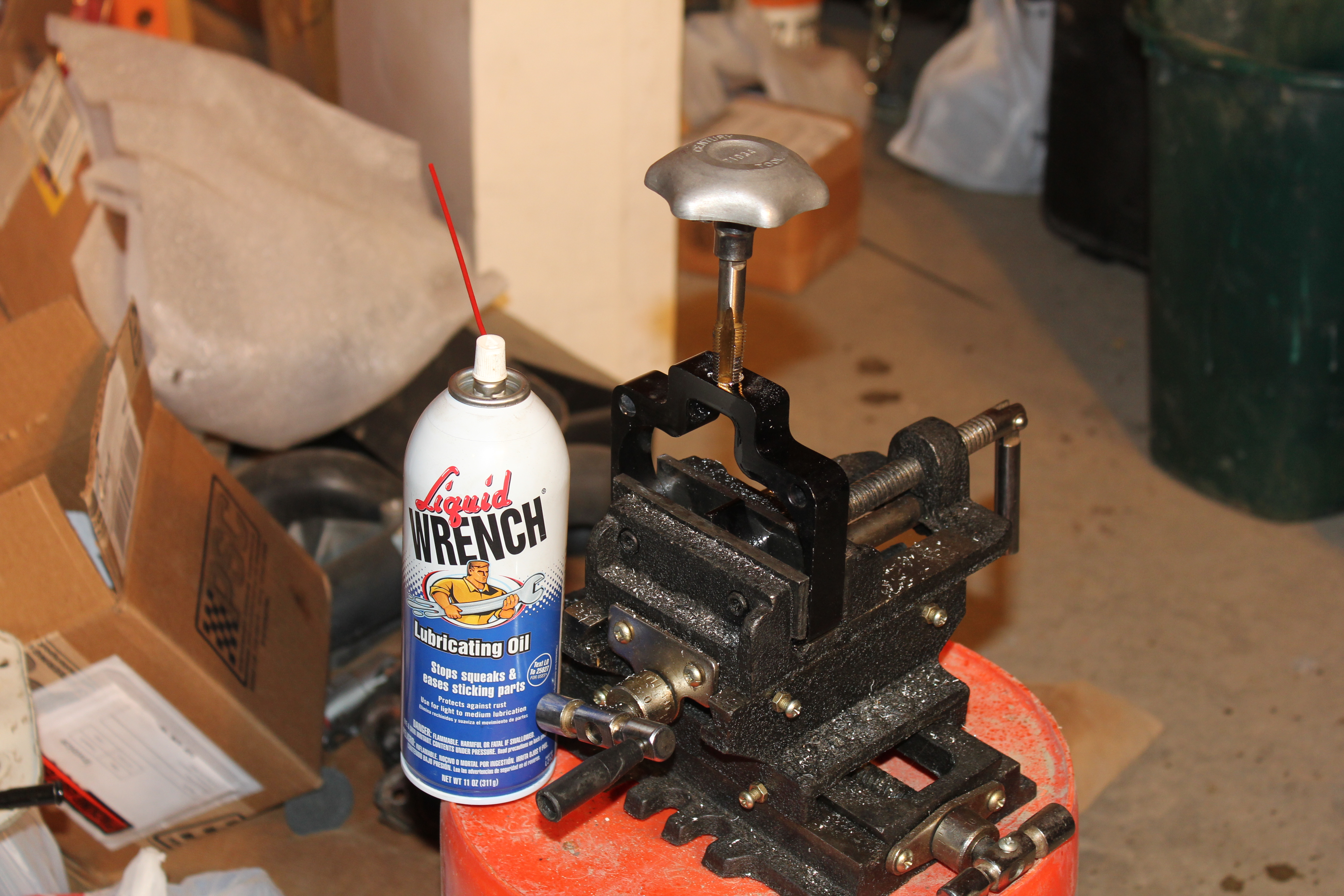

Started to tap it with this palm ratchet and that worked at first.

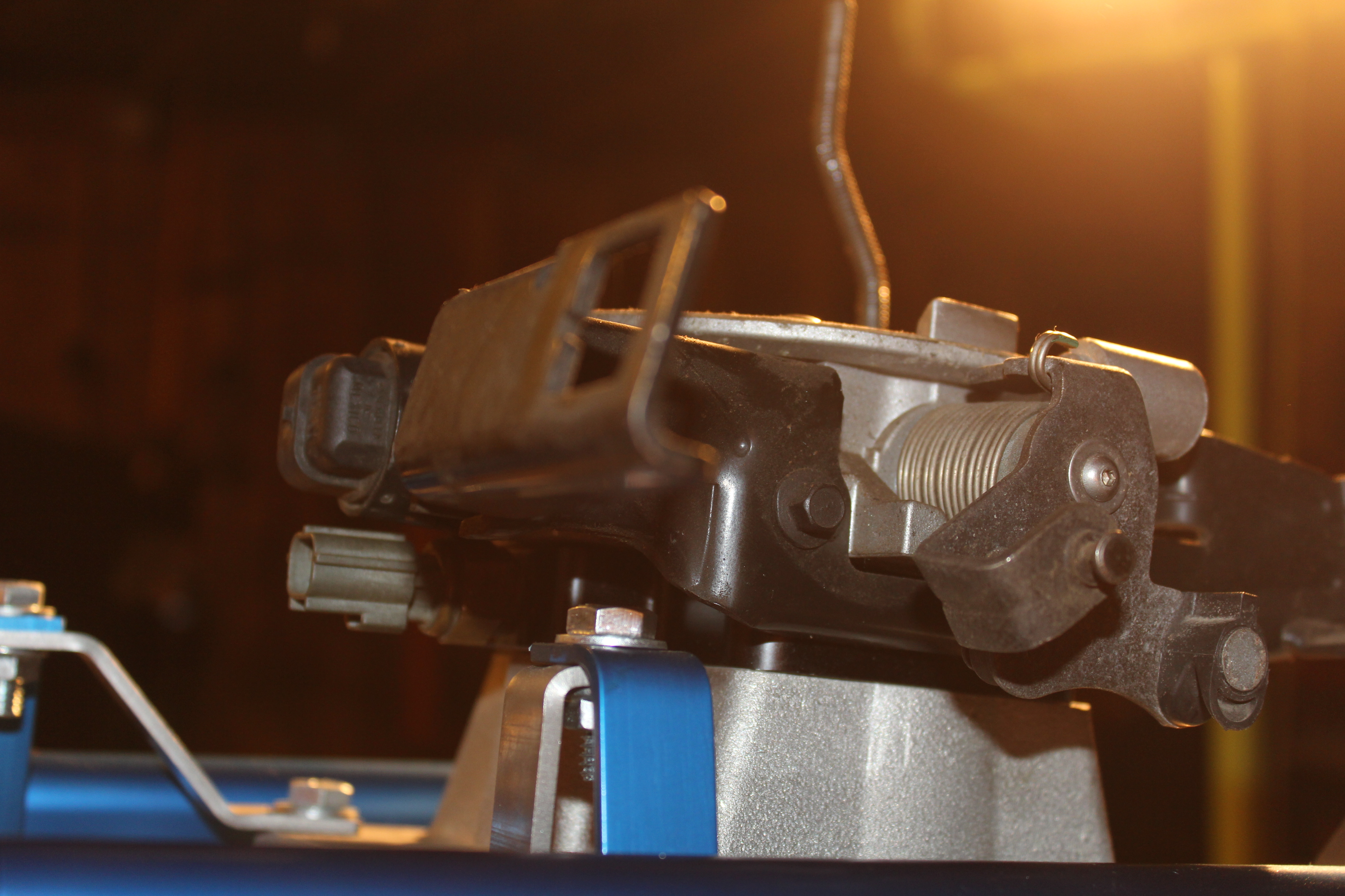

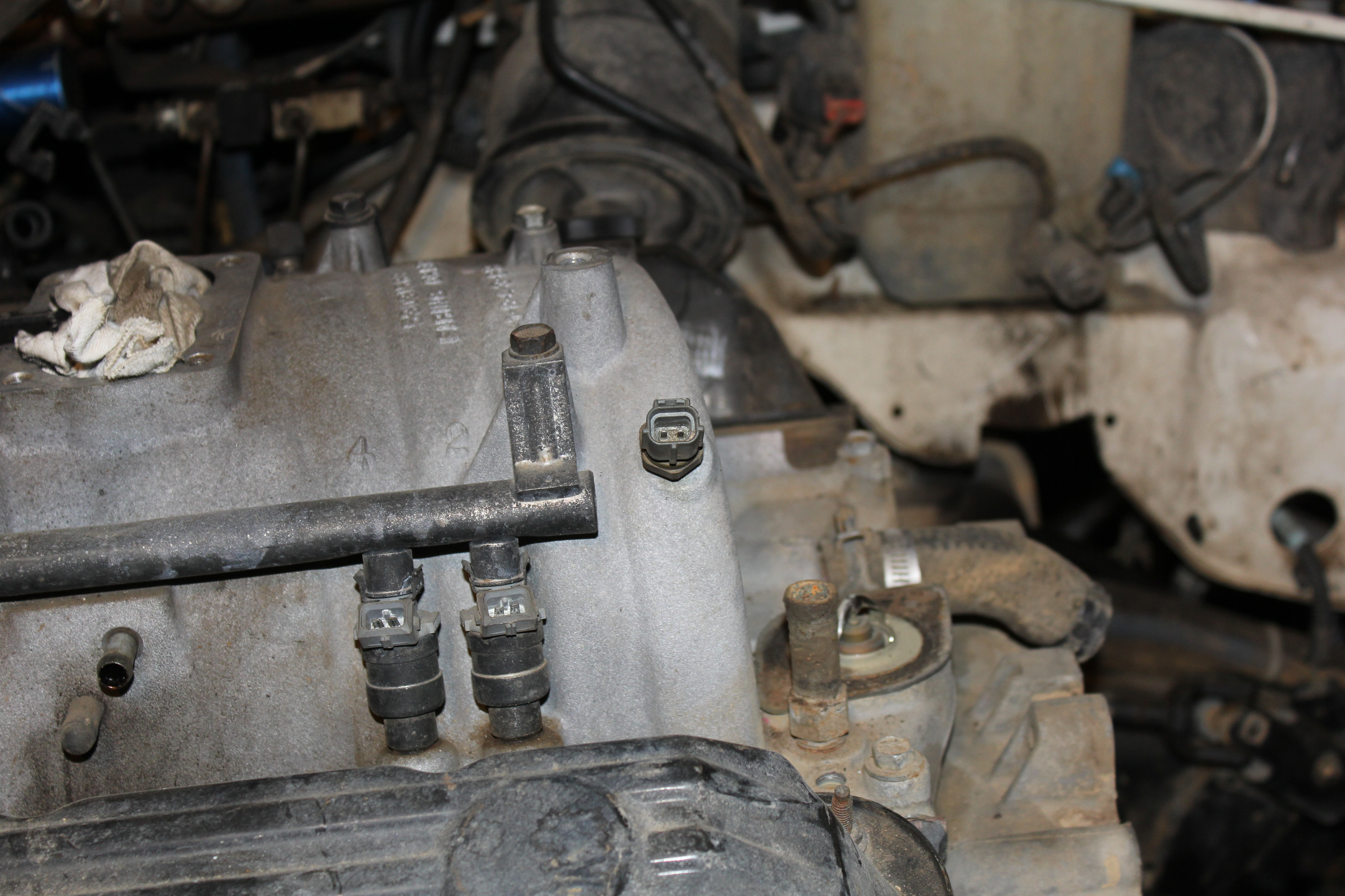

If you look at how the IAT is installed in the keg intake it sees the air temp of all the air which is why I decided to install it in the middle as opposed to one side or the other. This way it will get to see the air of both barrels of the TB instead of just one.
Let me know if you think I am going about this wrong. Always welcome input from all you guys.

OK I went back out to the garage after dinner and finished tapping the spacer. I wish I had better taps because this almost kicked my butt. I did finally get it done.

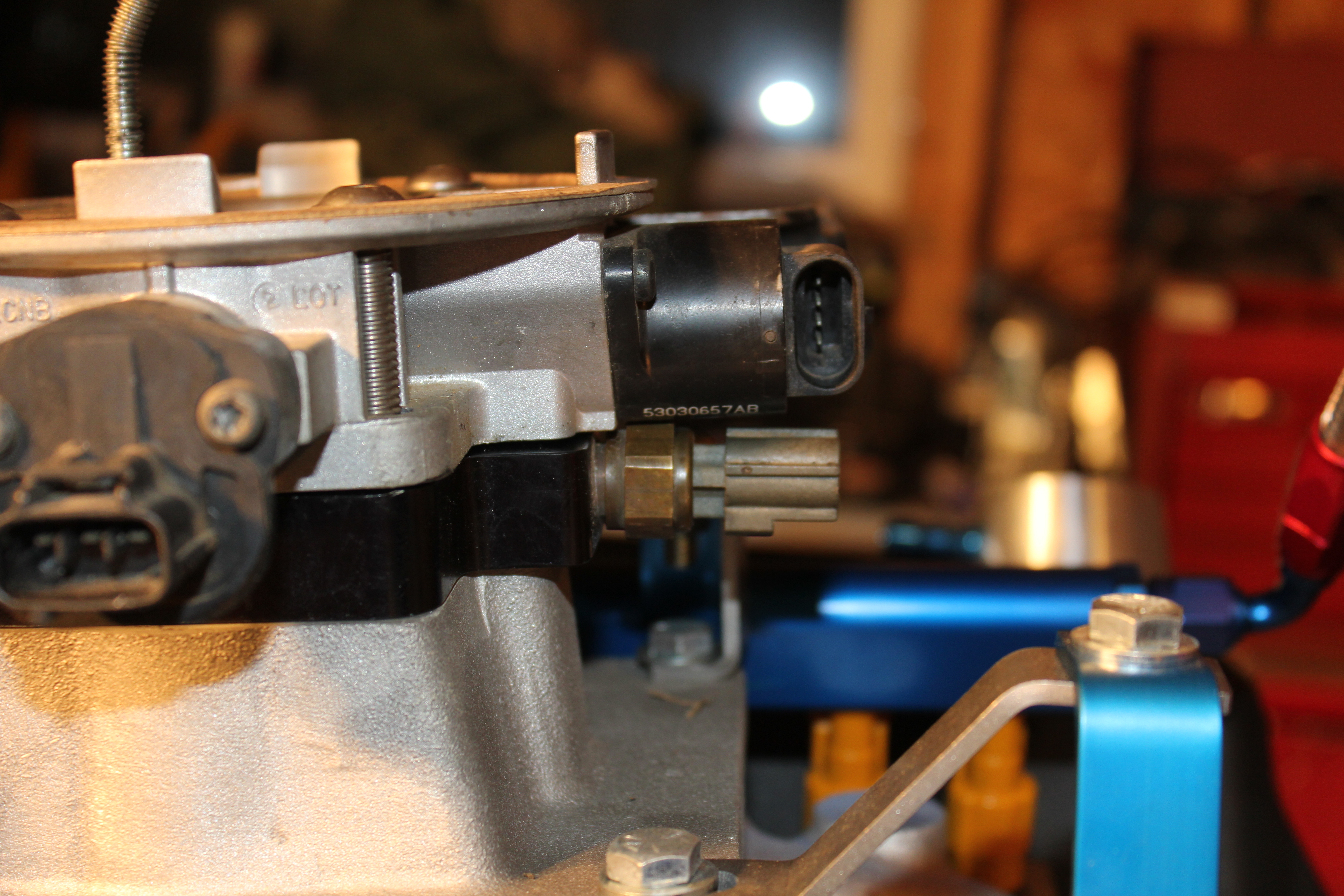

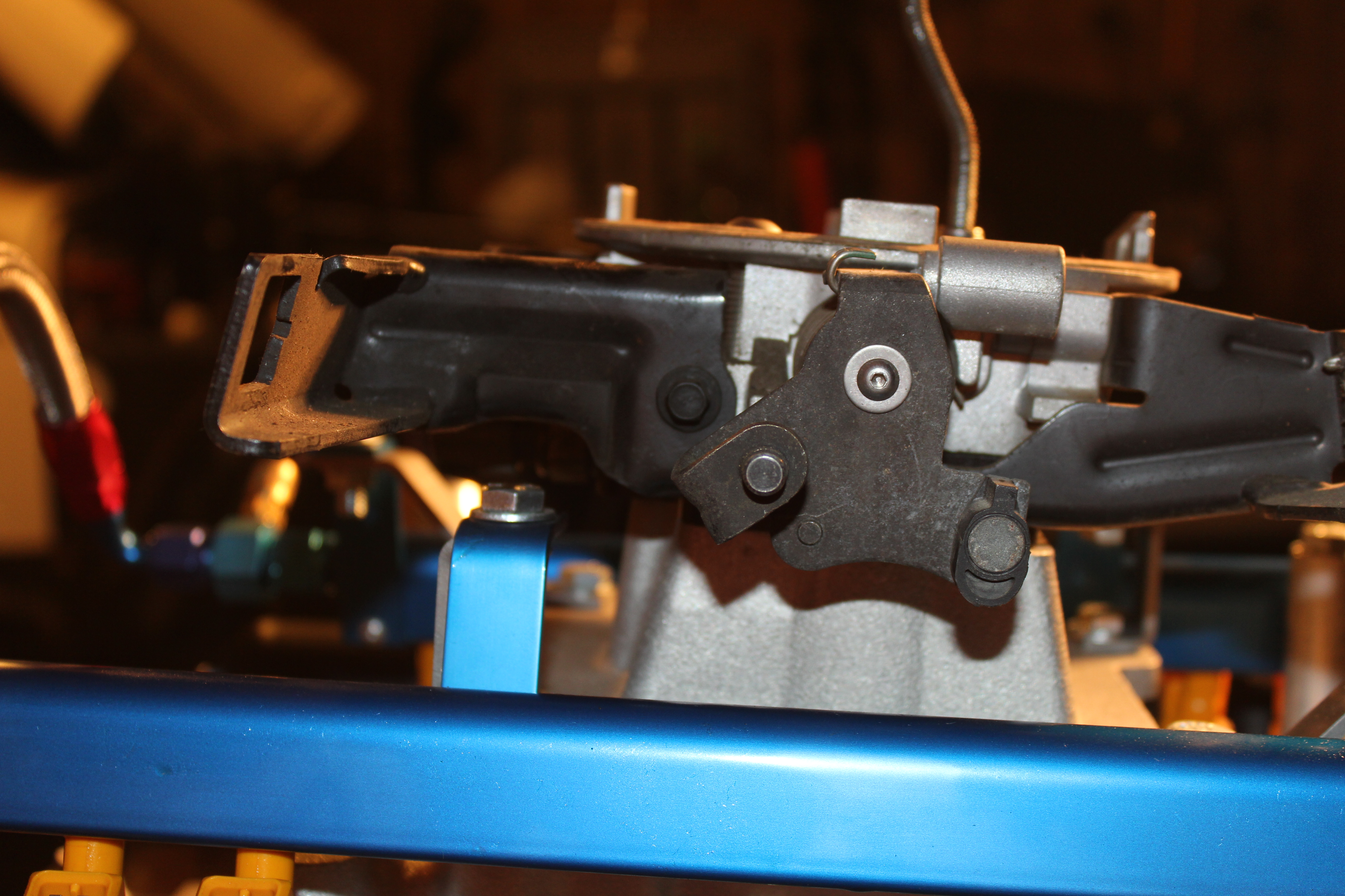

It's close but it is going to work. And there is an added benefit to all this too.
One thing some people complain about is that the throttle bracket hits the bolts. By using the TB spacer the throttle bracket doesn't hit the bolts anymore.
I'm headed out Sunday on a camping trip to go play with my Wildcat for 4 days. Then come home for 2 days because I have a doctors appointment and then head out with the daughter for a 5 day camping trip and runs with my Wildcat. When I get back I have to really get my butt in gear and get the engine swap done because I would like to take the Jeep on our family wheeling trip in July. Has to be ready before the 4th or I'll end up using the CJ 5 again this year. And the wife and daughter are on my butt to get it done because they like to ride in the TJ better.
