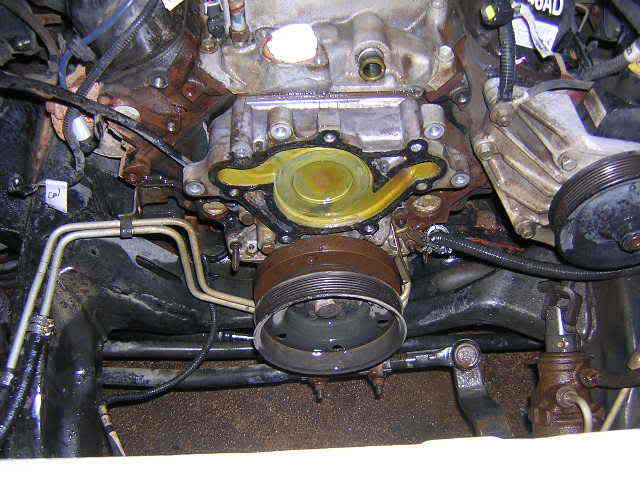

Old Jun 5, 2012 | 09:42 PM
dhvaughan's Avatar
dhvaughan
Joined: Jul 2006
Posts: 12,204
Likes: 10
From: Gainesville, Ga.
Originally Posted by BamaRam97
Is it possible to take the timing cover off without removing the water pump?
no.
water pump is stacked on top of the timing cover.
more pics.
https://dodgeforum.com/forum/2nd-gen...ater-pump.html
