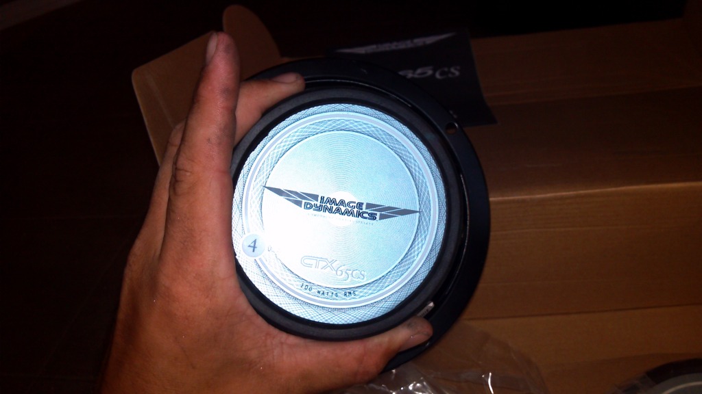

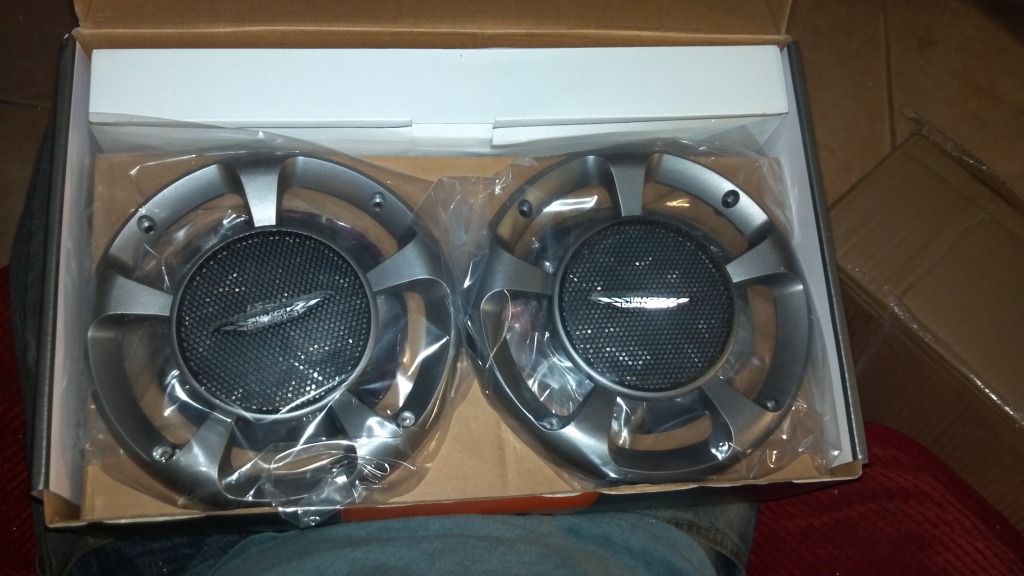

I've got a 99 QC laramee with the infinity system, And I wanted to replace my chitty blown front speakers for some better upgradeable (I.E amp head unit ext..) component speakers. So i decided to purchase some "Image Dynamics" CX65CS their component 6.5" with 1" dome tweeters and crossovers for $160.00. I went with a 6.5 speaker because there are alot more choices with 6.5 component than 6x9. ON TO THA PICS!
What i found when i opened the box

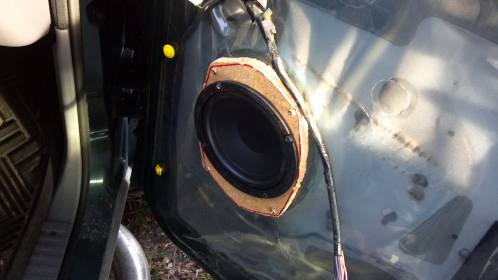

So with a 6.5 speaker I needed to make some adapters to fit in the 6x9 hole..I could have just bought some ebay plastic ones for $14 bucks, but after reading that they might rattle n such i decided that wasnt a good idea!
So i made my own out of 3/4 particle board, bought a 2'x2' peice for $4 bucks gonna make it MDF maybe later on. they only had a 4x8 sheet for $40 bucks so yeah, and btw im no wood master lol
made an outline of the 6x9
then an outline of the inside ring of the 6.5
then i used a router with a cutting tip (not sure wtf tip i used) to cut the 6.5 hole first and test fit
drilled some pilot holes for all the screws then painted it with this..just a clear
then using the stock speaker screws i mounted the 6.5 speaker to the adapter, then used the 2" screws supplied i mounted the adapter in the door. All the stock wireing pluged in, and i just zip tied the amp out of the way

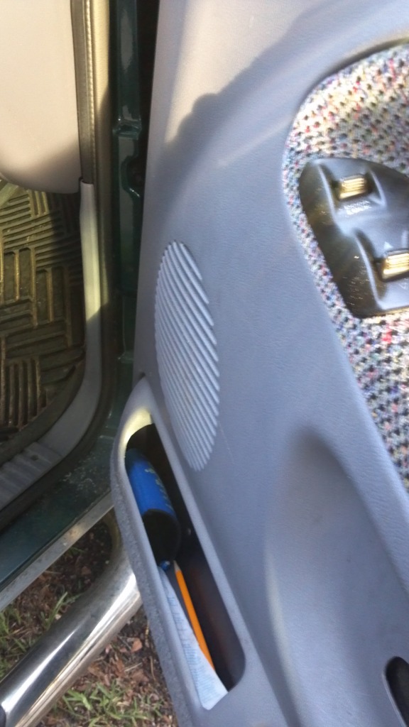

then slapped the door panel back on for fitment, only bulges slightly

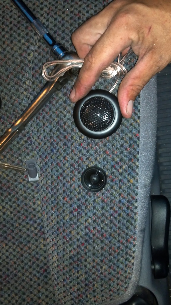

and heres a pic of the stock tweeter and the image dynamics one
yeah just so you guys know, The stock ones are pretty touchy and i broke mine getting it out. I'm not going to be able to mount the tweeters in the stock location (just to darn big) so im gonna have to figure out a different place.
