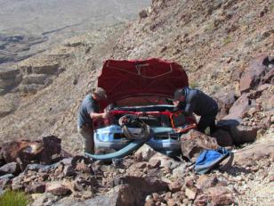

On a side note, I did find this late model Dodge 1500 with the 318 that somebody rolled off the cliff of this old volcano! It was being held there on the edge by a couple of large boulders. The interior was stripped and the tires and rims were gone. I am still puzzled over that. I climbed down and took the alternator and throttle body. Everything looked clean and preserved. I wanted the intake and valve covers but it would have been crazy trying to get those up the cliff.

Truck had been there a while huh? Any gas left??

Haha we didn't check. To get to the rear of the truck would have been suicidal and I hate heights! No the 4lo doesn't lock it in 1st. Although we could only go about 2-3 mph tops on that trail. It was filled with softball and volleyball sized rocks. Terribly annoying. I want to get the fan and wire it to come on at 180* or so. I will probably get a thinner nicer stacked plate/ fin cooler with a thermostat. I hear those allow more airflow. Thanks for the suggestions.
