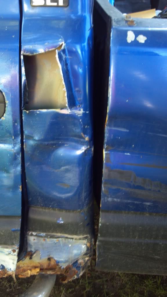

And heres where i got hit...i cut a hole and pulled alot of the cab straight....i need a longer prybar to get the rest but after some more prying shell look decent...and after some bondo work....
That's a pretty big hole to cover up! Bottom looks pretty bad also.

Meh that hole will be easy to patch....and the bottom looks bad but it really isnt all that bad....im going to cut the old metal and get a new cab corner from napa for $60....
And as for bushings...ill just replace the one arm for now...then when i get back to work ill just buy all new arms...the $35****in a piece is well worth it
