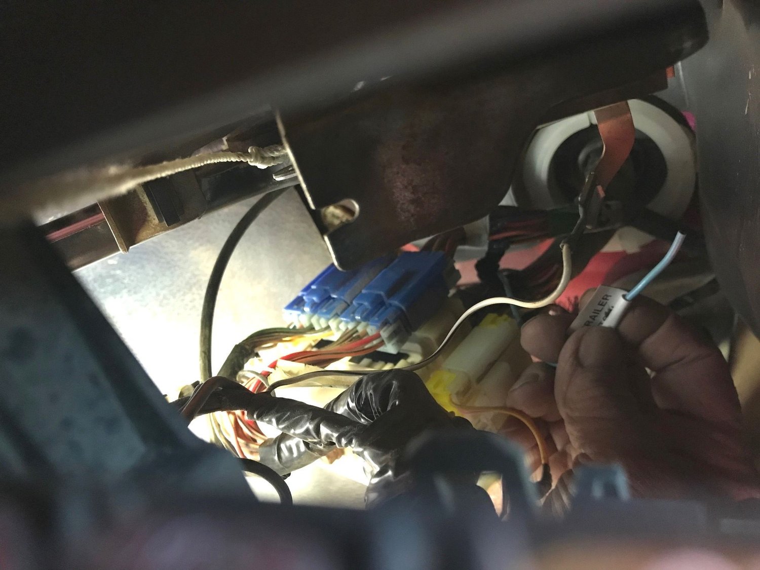

Old Oct 19, 2025 | 08:21 AM
GBinMT's Avatar
GBinMT
Joined: Oct 2025
Default I found the blue wire
I found the blue brake controller wire. Open the fuse box cover and look behind the fuse box at the wire bundle coming through the firewall. It's taped on the top of the bundle and barely visible. I can't get the image to properly orient- the bracket with the string is the parking brake. I hope this helps someone avoid the hours I spent trying to find it.
