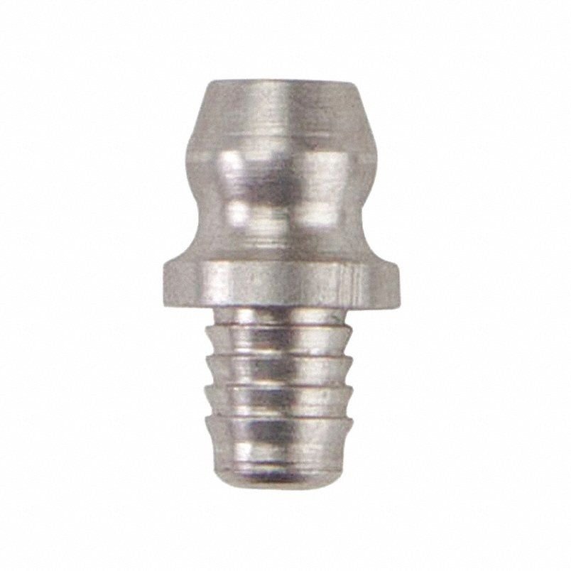

Thanks for responding. I know it's going to be a chore drilling. I have my trusty Craftsman carbide drill index ready to go. I have tap and die sets in both metric and standard sizes. Do grease fittings need a special tap, or will I be all set?

I'll be curious to know how it goes. Ideally if you're using solid carbide I'd want to do it in a mill or dp. If you're trying carbide-tipped masonry bits that's different and probably ok in a hand drill. Easy to trash solid carbide in a hand tool.
AFAIK zerks are just standard thread, often 1/4" or M6 but of course you can buy a lot of options.

I think the zerks are NPT, are they not?? Tapered Threads?
I think it depends on the fitting, I seen em all. Usually they work if you use a standard/metric tap(depends on the thread on the fitting). They make press in fittings also(barbed). If you are drilling spring steel i would get them. good luck trying to tap it. Need to know the size drill to use beforehand. Problem with them is if the fit is not tight enough the grease pressure pushes them out.
Actually yes I've seen them both ways. I prefer the straight threads because hand-tapping NPT is dumb
