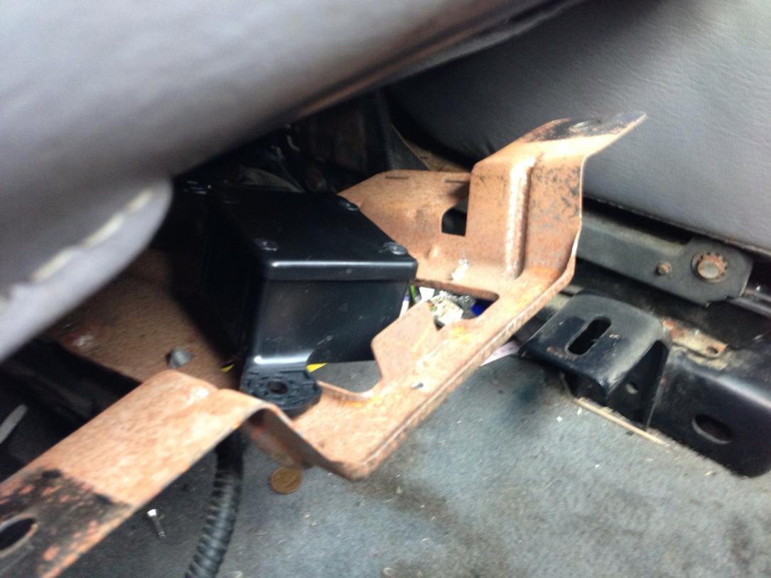

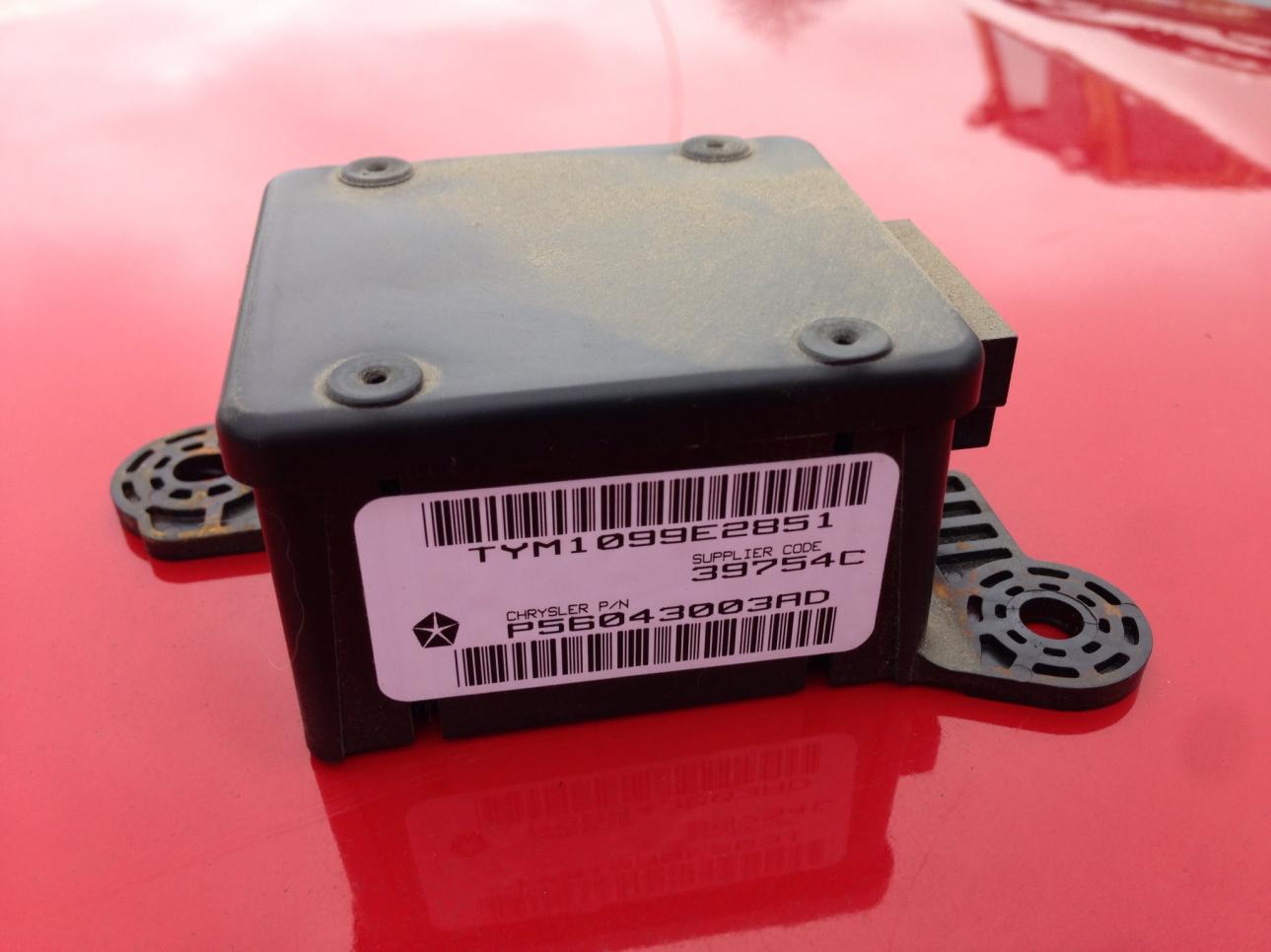

Default Black box under seat
I had the same problem with the seatbelts on a 99 1500. The box under the seat was toast so I replaced it. All the belts work fine now. (About $200 and 15 mins to fix)
