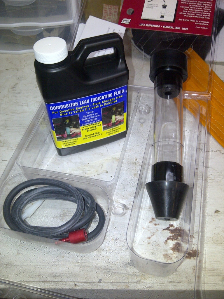

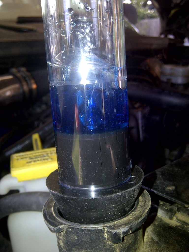

+1. That and a power bleeder are the next two items on my want list of tools. I also have one of these: Name:  combustiontester.jpg
This tells you if there are exhaust gasses in the coolant (turns yellow).
