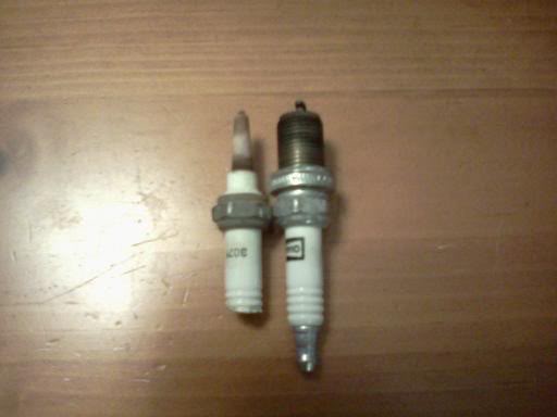

This was the only reason I built mine.

Whoops^^^
