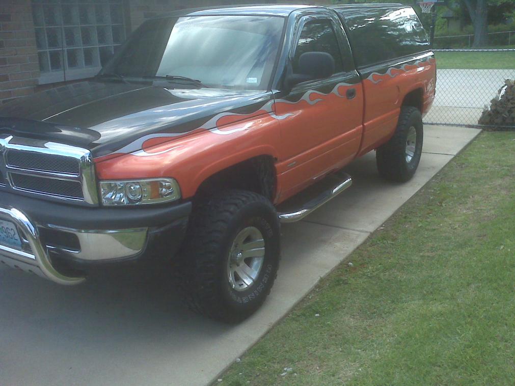

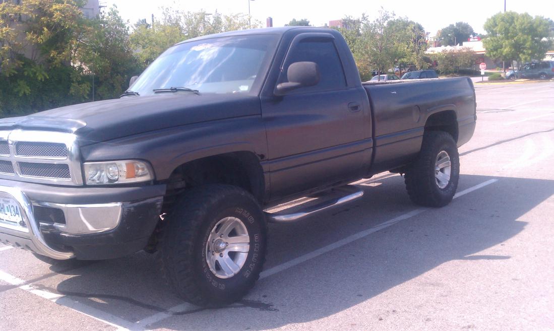

Thank you! Definitely missed that thread! Think i will change out the plenum gasket and do a full tune up. Any suggestions on plugs and wires for this truck? I know my jeep likes simple champion plugs, nothing special, and whats the proper gap for the plugs? Also when i say oil pressure drops sometimes the gauge will go completely to 0 and fluctuate. But it does only seem to happen at the end of an oil change and pressure checks out fine. Anything else I should look into as for oil sensors or is that kinda normal? Also, when i first got it and noticed the oil consumption i switched to a heavier oil and added lucas oil stabilizer to it and I think the thickness of that helped slow the loss of oil but it does eventuality get low enough to mess with the oil light. With that said, what oil should i consistently run in this for best results. I will say I use this truck! Its a daily part of my landscaping business so it is often weighed down or pulling a trailer so i want the best protection i can for this engine because it is really strong still and I want to keep it that way! Thanks again everybody! Heres a pic of my truck so far, when i got it it was custom painted like a harley, really cool but to much for me. Rt now it has a low gloss black metallic paint and i will be hitting it with clear coat soon. I really like the way it looks dark and not shiny, kinda like a tank
