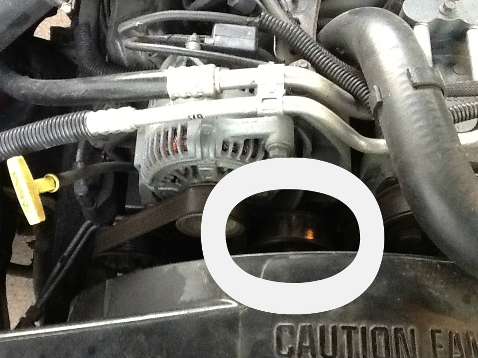

I looked when it was running and I think I saw a vibration in this pulley...

Thats the alternator....and if it was that youd know...you said you think you saw vibration...with that sound youd def. See something...i dont think its that....have you checked the crank pulley? Because like i said thats EXACALLY what mine sounded like when mine went
thats not the alt he circled. thats the idler pulley....

Or the tensioner.. cant really tell on my phone. Both are cheap and easy to replace if one is your culprit

Nvm!!! Im blind.. it is idler pulley lol

Im not seeing a circle and i dont even see the idler in the pic i only see the alternator.....my eyes must be shot
