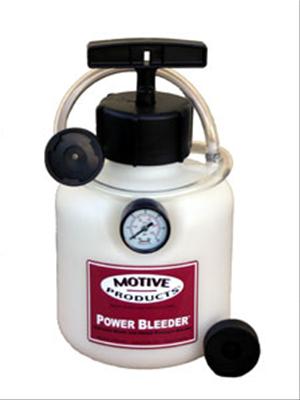

I was having the same issue a couple weeks ago hile on the road to Houston. Had a shop bleed brakes and it worked for 200 miles. Changed out master cylinder last eek as fluid looked dirty, and I anted to flush system. So I bought one of these from Summit Racing. Best buy in some time!
Brakes will stop on a dime and give change!
