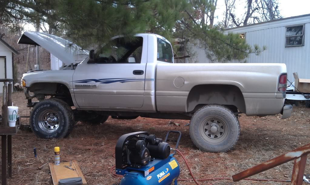

your lookin at 5" in the front, so you would need the things mentioned, or just dont level it and use a 3" lift with the 33s, will look fine. i have a pic of mine with the same setup. but its done with a 3" body lift at the time.
and if you wanna see what its like with 3" more on top of that...
soo Diesel coils installed and addaleafs in.
didnt use the front spring spacers just did the springs alone truck lifted up about 2.5-2.75 inches all around not bad
