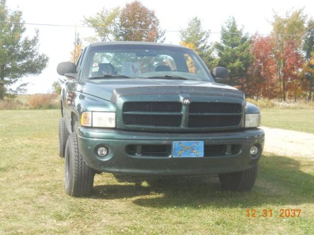

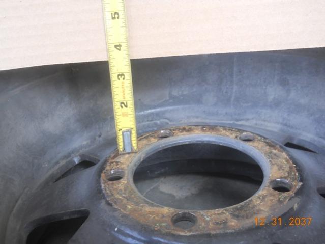

Ok, I finally had some spare time and remembered to get the pics.
The backspacing is 3.5". You can see they stick out a bit, but I like it.
Attached Thumbnails 15 inch rims on 2000 ram sport-dscn3324.jpg   15 inch rims on 2000 ram sport-dscn3319.jpg
