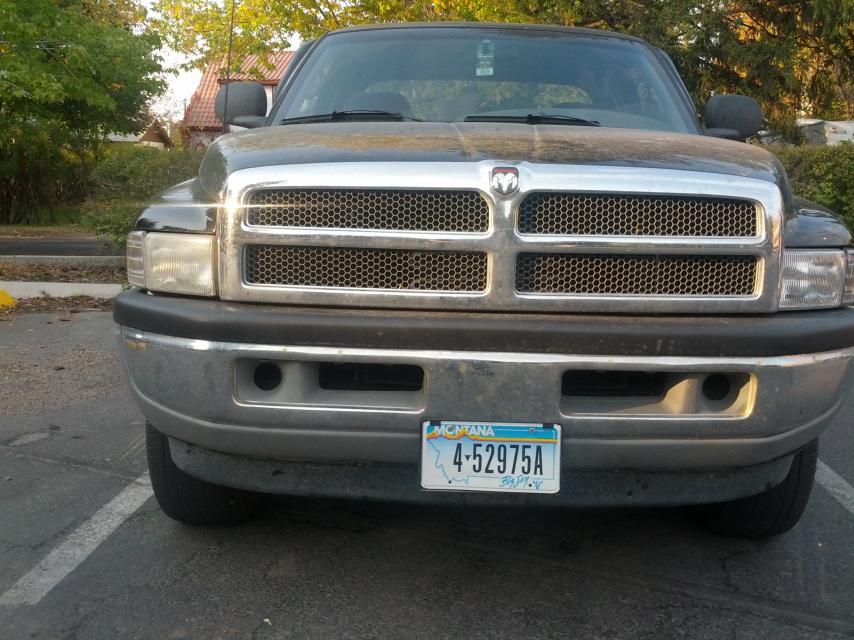

Old Oct 2, 2012 | 01:25 PM
white7wolf's Avatar
white7wolf
Joined: Mar 2012
Posts: 35
From: Montana
Wyoming,
Can you maybe find a link to that kit? I've attached a pic of mine... I don't have jack crap right now and really want to put in fogs. My guess is I probably don't have any of the wiring or anything. (I've done a quick couple of looks, and nothing has ever jumped up out at me for wiring).
Truck is a 99 Ram 1500, Laramie SLT with a 360...
Attached Thumbnails Where to find fog lights for good price-img_20121001_173915.jpg
