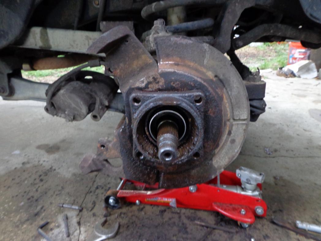

Heres the results of my time. and heres the stub axle.
Attached Thumbnails Need help ASAP!-dodgehub.jpg   Need help ASAP!-dodgestubaxle.jpg
Old Sep 19, 2012 | 07:12 PM
Posts: 87,437
Likes: 4,218
That stub axle is trashed. Do NOT re-use it. Good way to watch your front tire pass you....
