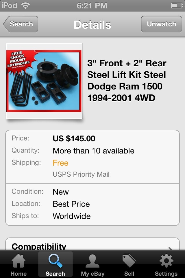

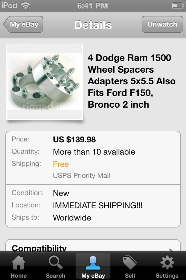

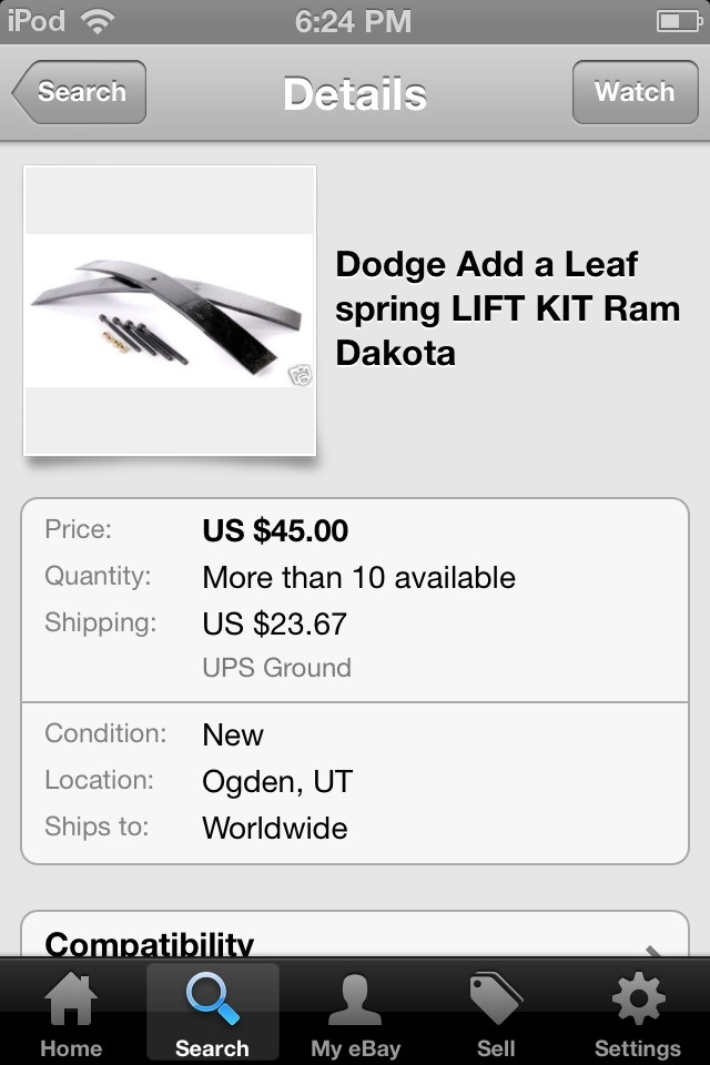

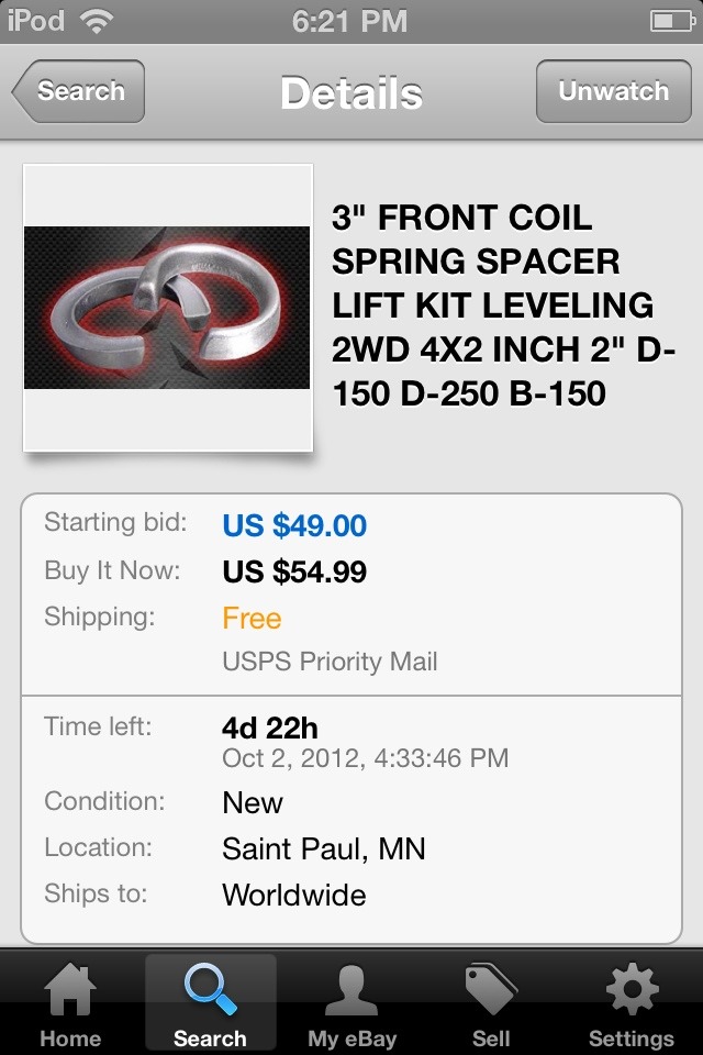

What about any of these? And has anyone else had problems with wheel spacers? I wanna know of the problems before I order them tomorrow.

Never seen or heard of the first one but it doesnt look to be of any kind of good quality. The second one looks to be like a regular leveling kit but like stated before with 3 inches your pushing the limits off your steering components. The AAL will look good until the springs settle and go back to the way they were before.. Happend to someone on here before.. Cant remember who though.. The wheel spacers.. Well those are just like the ones I had. They destroyed my wheel bearings and I kept having all the lugs coming loose. I wouldnt recommend them.. Its all on what you want to do but I personally wouldnt buy any of those products but thats just my opinion..

I have one of those "frankin-lift" set ups, 3500 diesel coils-$40 from junk yard, add a leafs $40 ebay, and blocks out of a 72 power wagon which were 1.5" higher than the stock ones. The add a leafs i got were like the ones the op posted, they only did like an inch and a half, if that. Overall i got 2.5-3" of total lift. I have to agree with the general consensus that the wheel spacer are bad, havent heard any good things about em
