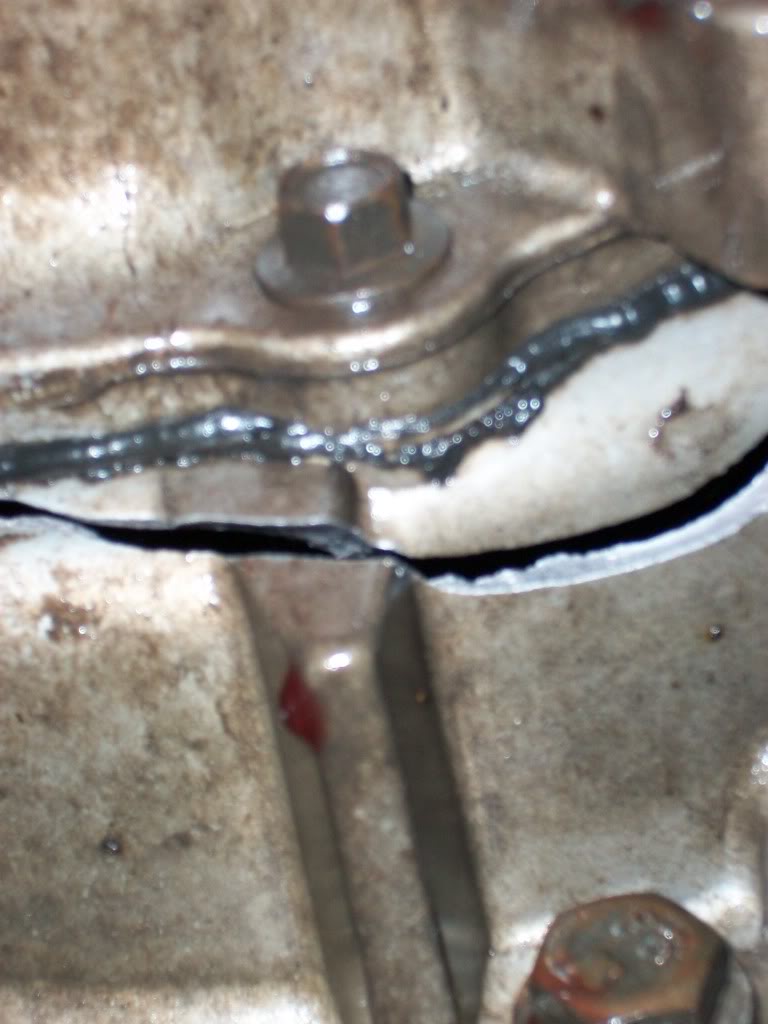

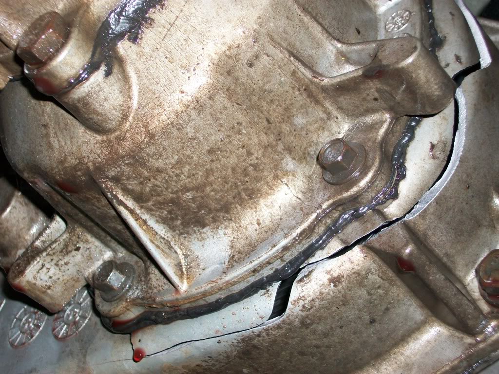

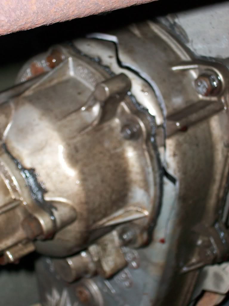

Originally Posted by BlackRam_98
As preventive maintenance, is the transfer saver worth the money?
