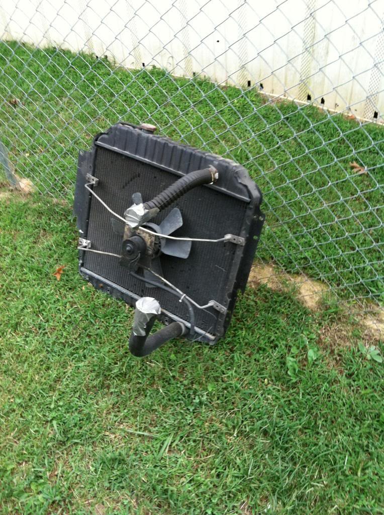

It just sucks that the 4bt radiator I have was from a van with a manual so no where to run ATF through it....
Any ideas here? Think snugging the trans cooler to the backside of the huge radiator would help any?
Tough to tell, but the thing is huge.

Old Oct 16, 2012 | 11:08 PM
Moochoff's Avatar
Moochoff
Joined: Apr 2012
Posts: 293
From: Spirit Lake, IA
I wonder if I wouldnt be better off running the 360 radiator w/ electric fans, with the 46re cooler....
They would bolt right back in and I would get my trans heat exchanger back
BUT I would lose cooling efficiency for both engine and trans....
It'd be an even worse option, dumping that much engine heat into the transmission. In the factory radiator the two circuits are essentially side by side, and the aux cooler (if you have a towing package) goes in front of the whole shebang on the downstream side.
You might want to make a junkyard run and scrounge the bits out of a factory diesel.
That fan will not cut it! You will have overheating issues.
