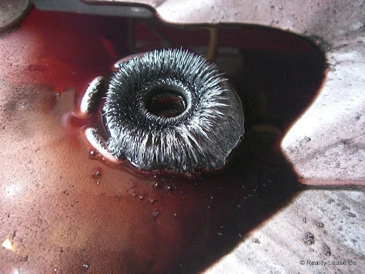

Originally Posted by gdstock
Was there a magnet in the bottom of tranny pan? That solenoid is the usual suspect on shift issues. Little pricey from Oriellys, but the right part!
Well I live in Thrall, Texas so the wait on internet order is about 3 days longer then they promise me.
Yes sir, this was the second time I pulled the pan. The first time I pulled it I changed the tranny fluid and cleaned the magnet spotless.
My magnet looked a little better than that, just hair no chunks.
http://lh6.ggpht.com/-trTztsT0Dgo/ST...I/CIMG3437.JPG
When I threw it back together it did not fix the problem at all, so I decided to go with the solenoid.
