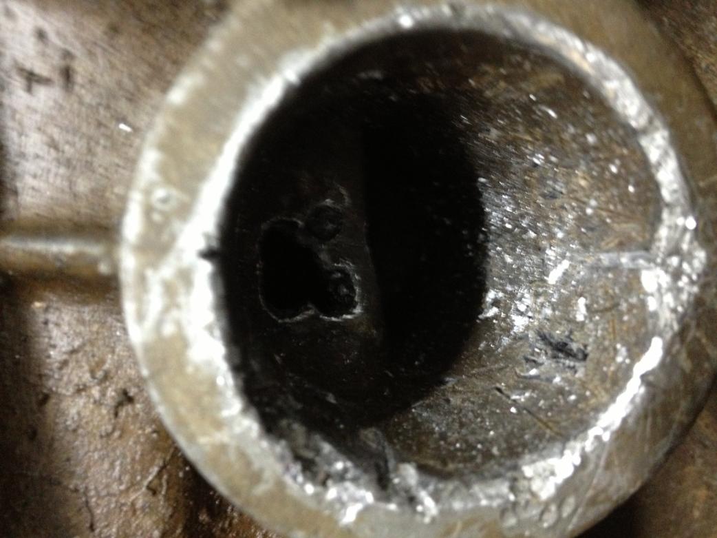

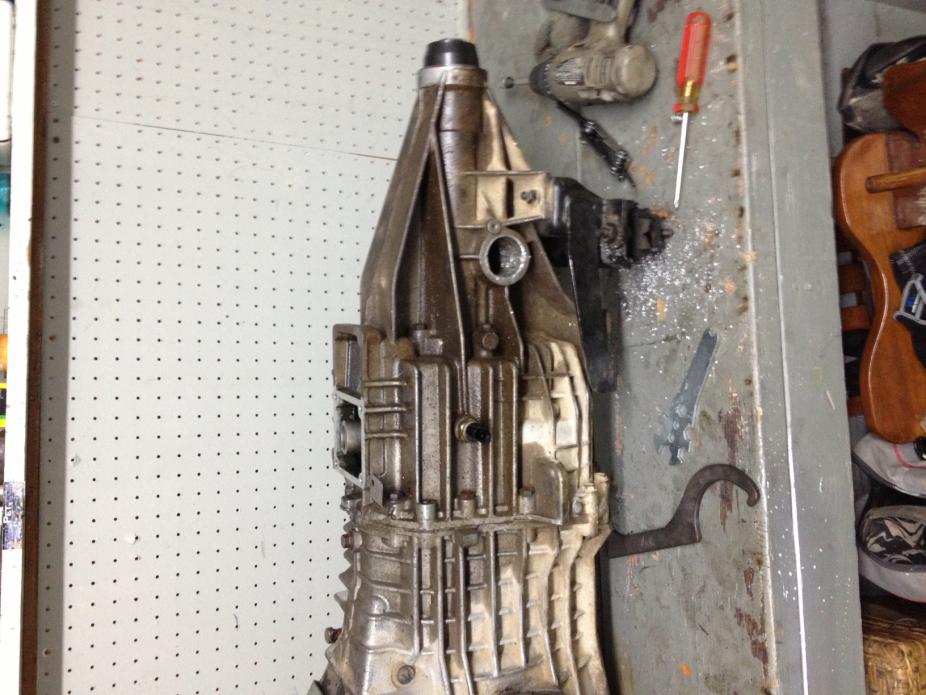

Then I'd say you got the wrong year tranny. Not like it will help, but post a pic of said cap.

here is a pic of the tranny itself and the capped vss.
the holes you see in it are from me drilling into it and trying to pull it out (like a dent extractor, only I don't have a dent extractor) using a long driller screw.
I think youre right. wrong year... but what to do?

With a broken VSS my idle behavior was certainly altered but it never died. Try hooking up the VSS electrically but of course not in the trans and see what happens. And yes, you picked up a newer trans. Also you may try turning the screw on the TB to open the blades a bit more.
