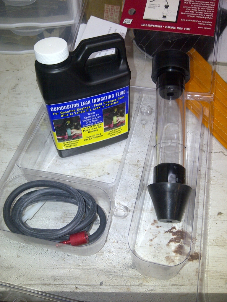

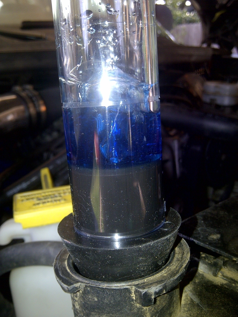

These seem to have an uncanny capacity to leat at thermostat housing...right where you cannot see it. ANd it may dry before you ever see it drip underneat.
+1 more on pressure test and combustion testing.
