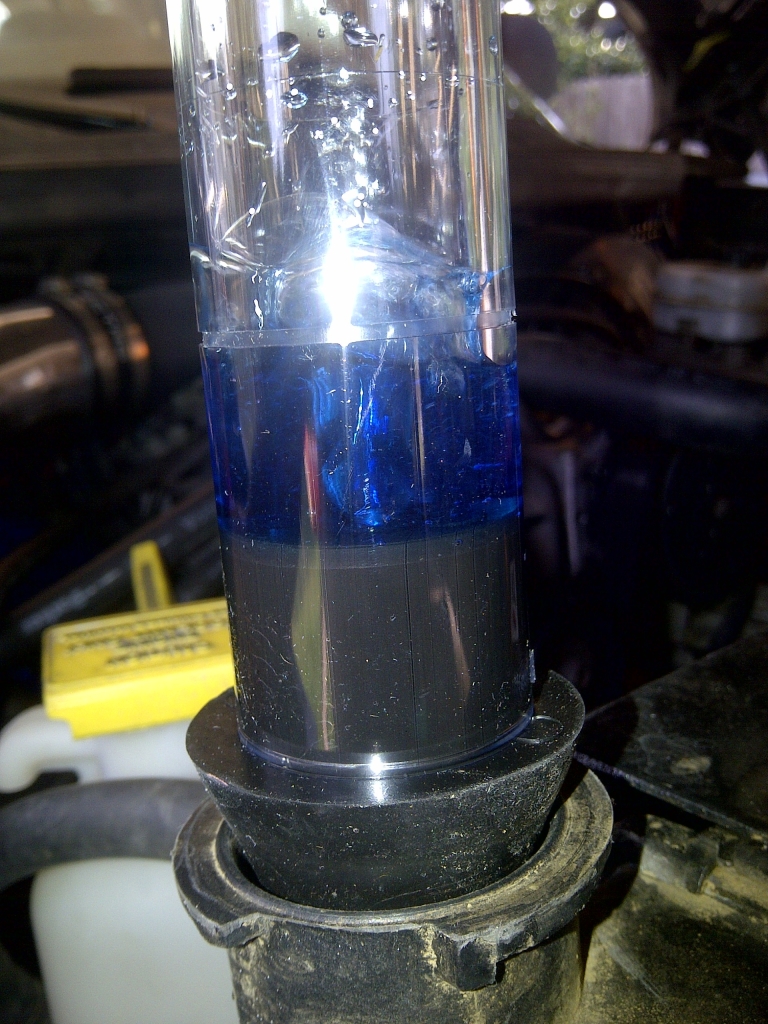

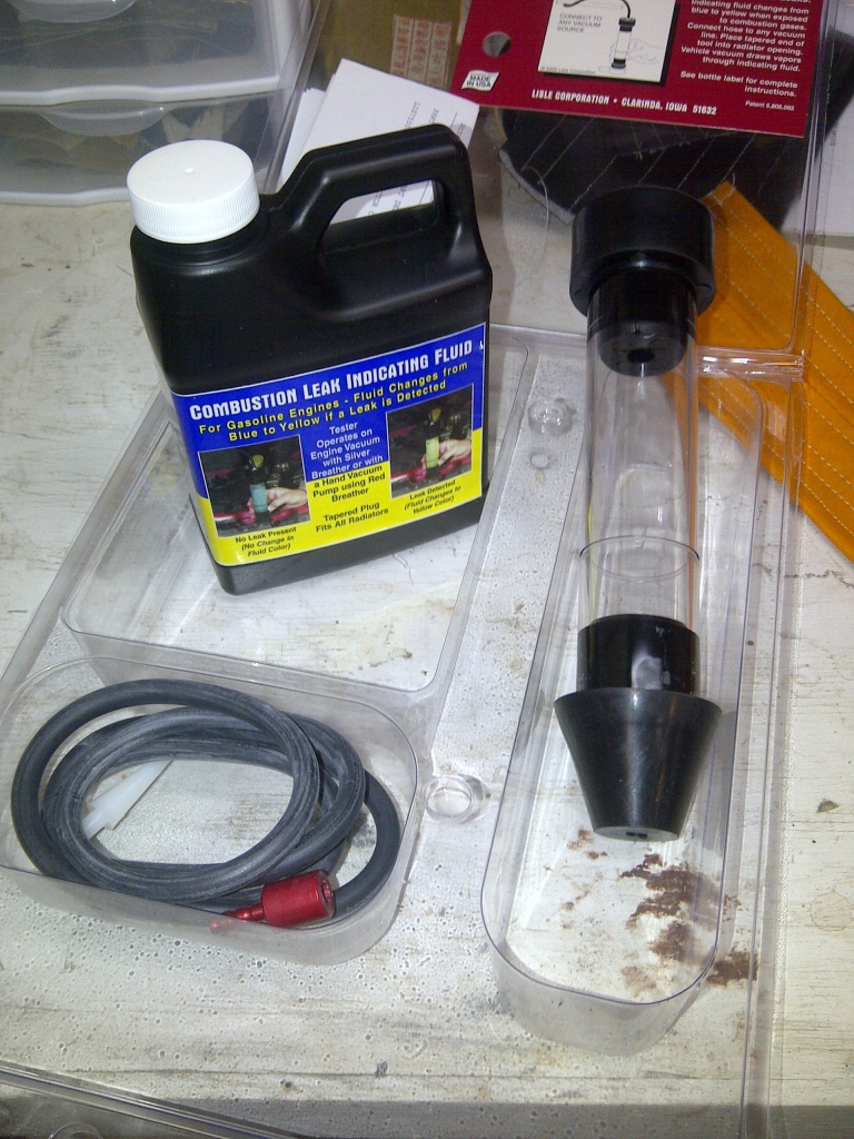

Get the test kit for combustion gases in your coolant.
Have a look at your spark plugs. Generally, cylinders with a leak will be very white, and exceptionally clean.
Looks like this:
During testing...if it turns yellow, you are leaking combustion gasses into coolant system.

sorry it took me a while to get back to you guys. I got a block test kit and tested for combustion gasses in the coolant, and it tested negative. I ran the test 3 times. I also put it by my exhaust to make sure the test fluid was working properly and it turned greenish when sucking in exhaust fumes. I pulled the top hose off the nozzle to make sure the nozzle wasnt cracked and it wasnt, but it had little bubbles in the plastic..like paint bubbles. It looked like what would happen if it got melted but I know the coolant didnt get that hot to melt the plastic. This could make for an eneven mating surface of the hose and nozale causing coolant to seep by, even though I have 3 freakin hose clamps on it.
