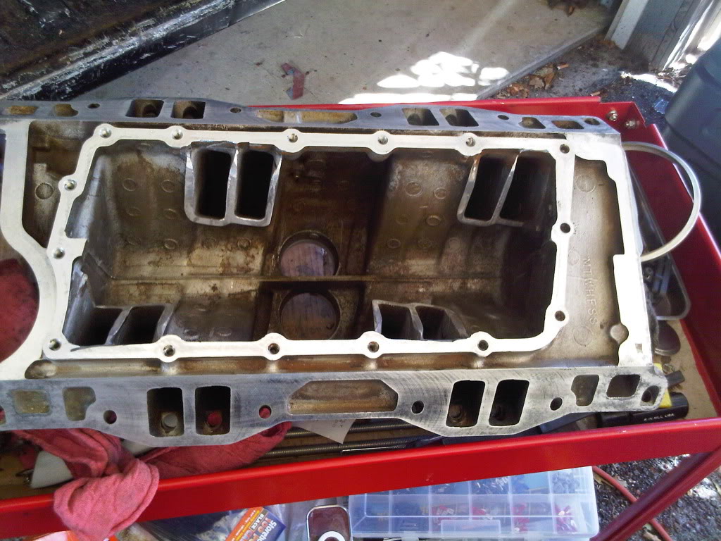

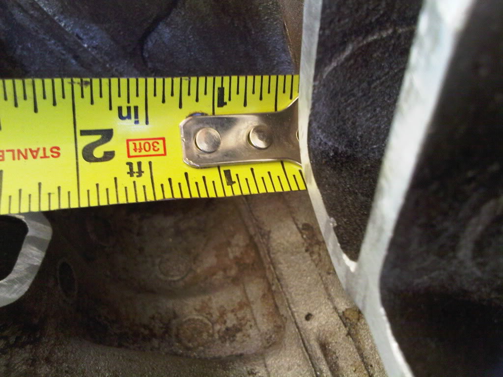

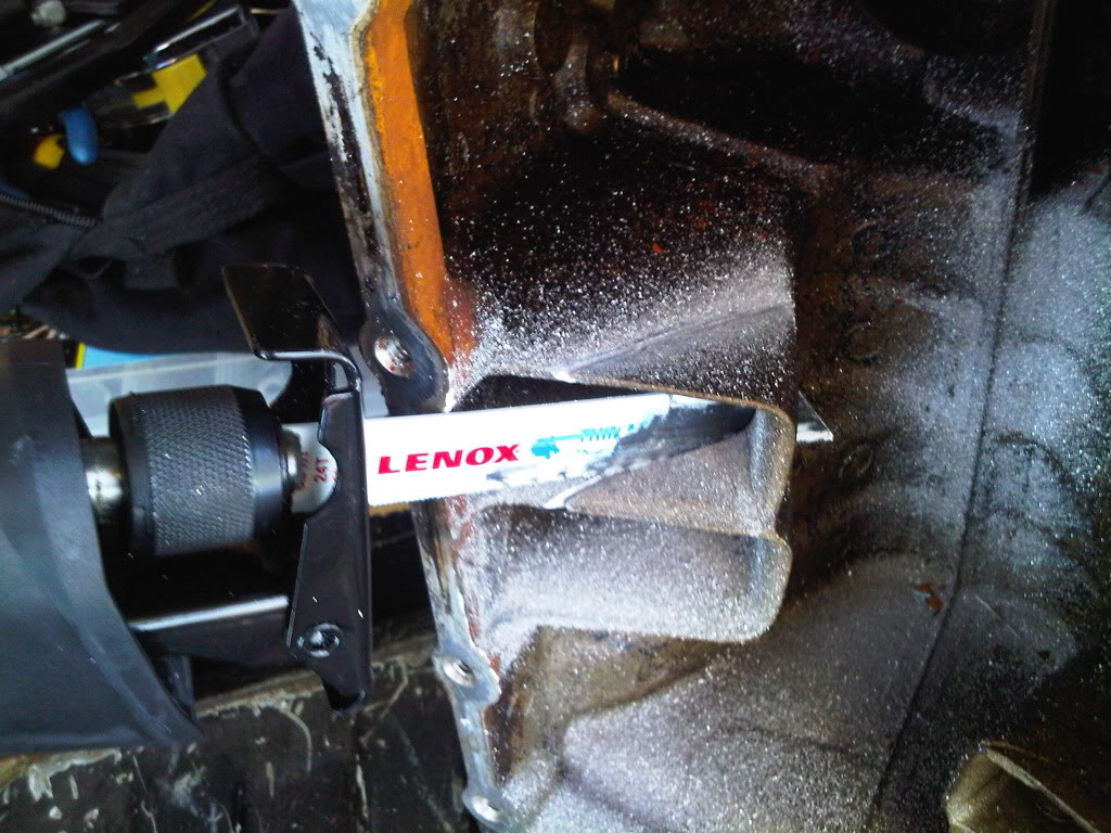

The engine is still in the truck, my brother drives tow truck so I can take it anywhere I need to, but they still can't deck the block in the truck I'm assuming... The cylinder walls are almost perfect and almost 0 ridge which is awesome! I replaced the WP about 4k miles ago. The Odessa heads advertise "ready to install" but should I still have them decked? What is the best way to clean the injectors, and can they get screwed up easily? Also, just to clarify what do you mean by knocking intake runners down to 1.5"? I'm trying to visually understand because I haven't had anyone mention the intake runners. Last question, how difficult is it to change the oil pump later on this guy? My 350 wasn't a big deal, but would I need to break down the top end of the motor again if I did it later?
Old Feb 17, 2013 | 10:07 PM
  #40
gdstock's Avatar
gdstock
Joined: Jul 2011
Posts: 8,259
From: Austin, TX
Cutting intake runners:

After cutting, before rounding and polishing:
All runner cut:
