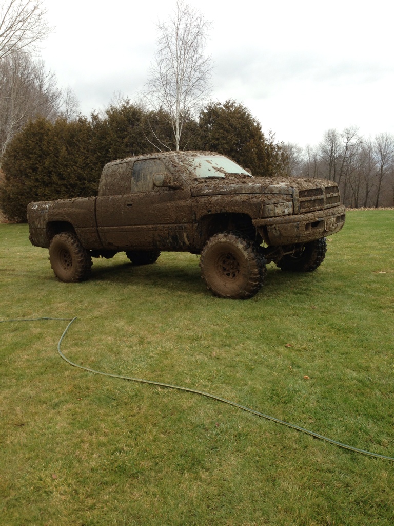

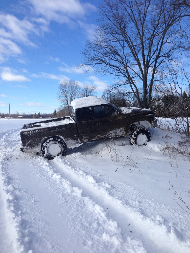

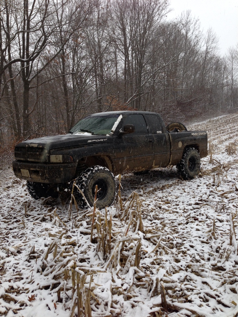

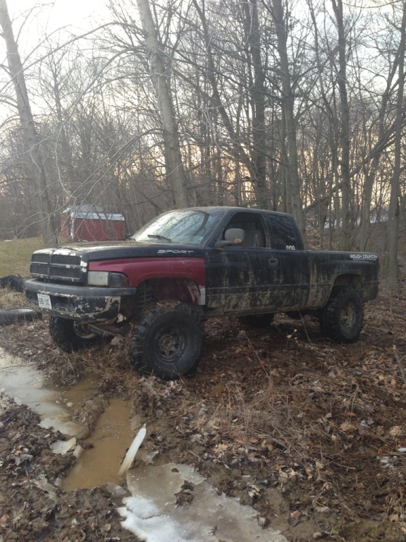

As for suspension Im running Rough Country 5" coil and a 6" block and AAL out back on 38" TSL's.
Before putting the block out back
