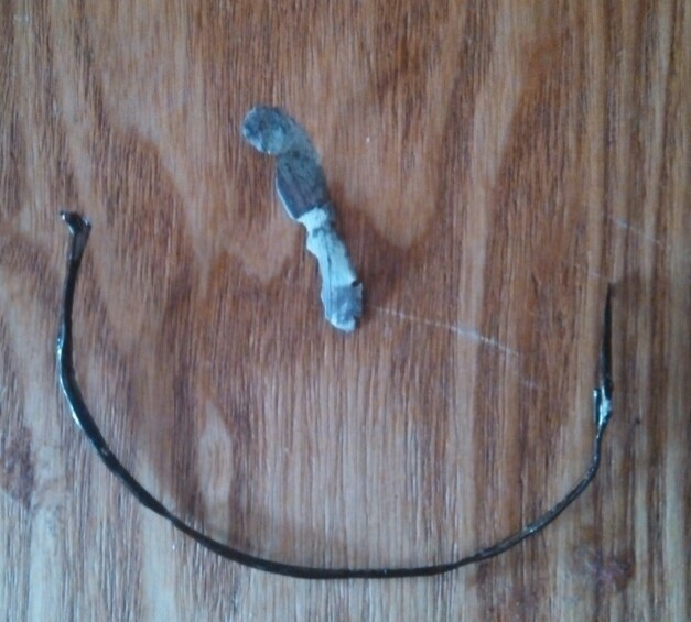

Old Mar 18, 2013 | 05:17 PM
clarke83's Avatar
clarke83
Joined: Oct 2011
Posts: 19
I finally figured out how to post a pic of what i found in the oil pan and stuck in the pickup tube. There was alot of the foil looking metal peices and some other parts of the half circle so where ever that came from im guessing it was a whole circle
Old Mar 18, 2013 | 06:24 PM
guzman's Avatar
guzman
Joined: Sep 2012
Posts: 219
From: Kansas
That bottom piece looks like sheathing for an electrical wire???
